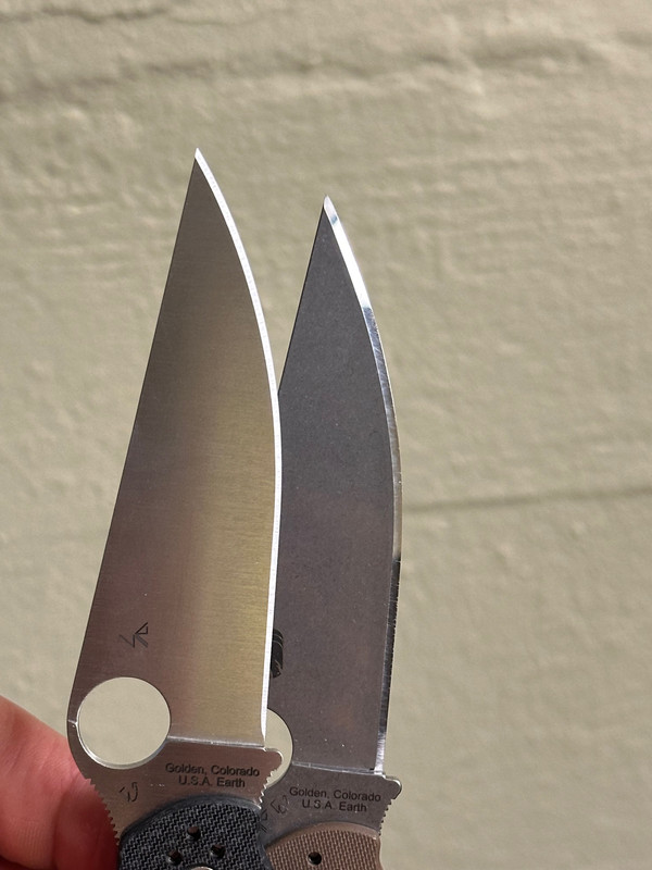

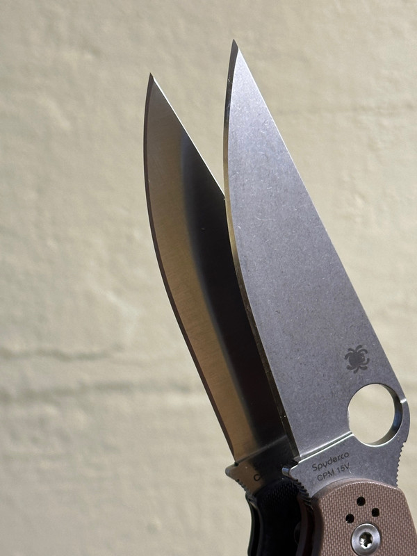

My 15V M2 has been with me most of my non-work hours (office) since it arrived. While the last few mm of tip actually wasn't apexed from the factory, the edge performed very well through weeks of regular garden/shop use before I finally decided to sharpen it last week. I've had my 15V Mule at 30 degrees inclusive for at least a year and have loved that edge (still stropping back!), but wanted to push it a little farther. I put the M2 at 25 degrees inclusive on my guided system using an Atoma 400 plate for re-profiling, the Venev Orion diamond matrix stones through 1500, and a 1um Gunny Juice strop. It's mirror-ish and shaves well and the change in geometry has made a new favorite knife even more favorite-r in use. The new edge has not chipped or rolled yet. We'll see how long this edge lasts...
Here are some pics of the new 12.5 degree edges next to my essentially unused S90V M2 facotry edge for reference:
