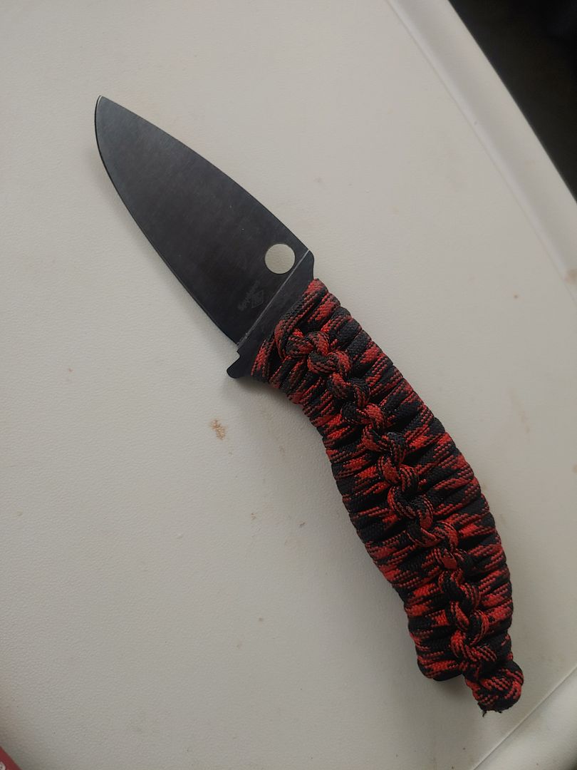

I'm actually halfway there already, and I have some SiC belts ordered for my 1 x 30 belt sander which should take care of the rest. Thanks anyway.

I may take a little more of the belly out toward the tip, but that's what it looks like now.

May i ask how you broke the tip off?

Cutting out caulking to replace it. Working between a countertop backsplash and a sheetrock wall, like I've done a hundred times with other Mules. I wasn't prying, but I must have put too much lateral pressure on it having my fingers between the handle and the wall.

Did you bring the spine down or the belly up or both?

I took the spine down just a tiny bit. Mostly I brought the edge up to meet it. There is still a small flat at the very point.
