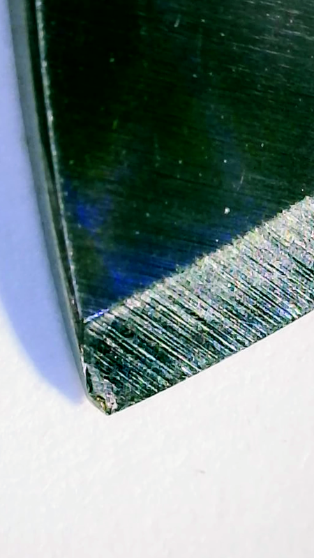

I have never seen LC200N chip out in my use, but I have had plenty of rolls. More than any other Spyderco steels I have used. Could it be its high toughness yet relatively low hardness compared to others? I don't know.
I had some beer cans out today and wanted to play around with some serrations. The K390 Endela serrated pierced and sliced some cans like it was nothing. I had my Spydiechef on me too, so thought I would give it a go. First can pierced with the Chef bent the very slight tip of the edge. Just happened to run my finger down the edge and felt something grab. No damage to the K390 Endela or its serrations through a few cans, though I have managed to bend and break off some of its tips recently. Not sure what I did that on. The Endela with its thinner tip seemed to hold up better where LC200N rolled a bit. This has been my experience using it on my Pac Salt (rolling) which sees a lot of use over the summer vs my K390 Endela in Plain Edge that even my wife can't seem to destroy. Though K390 is NOT nearly as tough as LC200N, toughness alone doesn't necessarily transfer to the edge. In my use, K390 seems to hold that edge under abuse much better.
Does LC200N roll so much it turns me off? Absolutely not! It performs very well. I cannot get it to rust even when I wear it in the pool and in the ocean IWB. It sharpens ups nicer than anything else I have experienced. It is a fantastic steel, but I wouldn't say it is close to K390 on edge stablity. I have not tried Magnacut, but I guess it would depend on the heat treat and what Spyderco is trying to achieve with it. If they are shooting for higher corrosion resistance and not nescessarily higher edge retention that may change its performance and put it closer in line with LC200N. That is way above my pay grade and knowledge however. I'll go back to cutting up beer cans while someone else answers that.
LC200N after piercing one can. As to the bent tips of my K390 Endela a few weeks ago, I don't know. I still haven't made an opinion on K390 in serrations. Just so you know, my bias in steel is towards Cruwear. Very tough and holds up to abuse very well at the edge. Also sharpens like a dream.

My experience with LC200N is that it rolls fairly frequently at acute angles as well. I use a custom in CPM Magna-Cut (62-63HRC) and it holds a pretty acute edge for a while without chipping or rolling. If you like CPM Cru-Wear magna-cut behaves similarly in my experience being a little more difficult to sharpen. I’m excited for the new Native Chief LW in it.JSumm wrote: ↑Sat Jan 27, 2024 2:28 pmHey Gernot! I have not experienced Magnacut. Very curious about it and how it ultimately compares to other steels. The below example is why I do not think that toughness alone translates into better edge stability. This is just my experience with LC200N (Pac Salt PE and recently acquired SpydieChef) and K390 (Endela PE, Endura PE, and recently acquired Endela SE).
