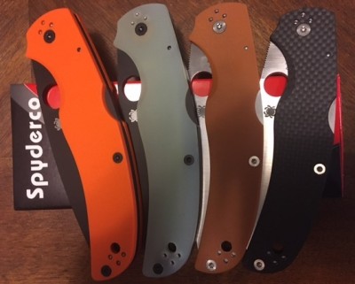

attila wrote:
Wed Jun 09, 2021 6:28 pm
I’m fascinated that my Rex 45 Chief has perfectly even & flush back spacer and lock bar, but the BHQ M4 Chief has not even a millimeter of flushness with the scales.
Im guessing that either the scales were made too big, the back spacer & lock bar were both made too small, or the scale screw/blade stop holes in the scales were drilled off by a bit.
I disassembled it and adjusted the scales as best I could, but they’re still a bit off along the entire backside of the knife.
It’s disappointing to have paid $192 and still find basic construction flaws.
Agreed. I was a little disappointed to see and feel the difference between g10 and back spacer.

Since it is overlooked, I found the post I referenced further back:
Michael Janich wrote:
Wed May 10, 2017 7:30 am
Dear Boar-Gen:
One of the necessary compromises that comes with black coatings is that adjoining parts can't be finished together. In the case of the satin-finished Karahawk, the G-10 ring spacer is installed and THEN the back of the handle and interior of the ring are sanded so everything is perfectly flush. This is impossible with the TiCN-coated liners because sanding would remove the coating.
We are constantly looking for ways to improve our products and will definitely take your comments into consideration to see if there's a practical way to tighten the tolerances on the ring fit of black Karahawks.
Thank you for your feedback!
Stay safe,
Mike
I'm pretty certain this is the same issue with the coated NC M4.

My M4 Chief arrived today and the blade is as beautiful as I imagined. The rest of the knife could be better. The scales stand about 1mm proud of the backspacer. The fit and finish on my S30V chief is outstanding with the backspacer perfectly flush with the scales. The jade scales are also about .5mm thicker than the scales on the stock model and the screw holes seem to be milled a little deeper so all of the screws are recessed a bit into the scales.
I’ve compared the scales on the stock model to the M4 and I think it may be that the screw holes are not located in the right position on the backspacer.
If I wasn’t in Canada I’d send it to the mothership for an overhaul no question. What do you guys think?

Theldraskien wrote:
Fri Jun 18, 2021 11:21 am
1mm sounds like a lot. I'd send it in, I guess... I might be wrong but somehow it seems to me those sprint runs are getting kind of sloppy.
I didn't send in my Rex45 Chief (spring stands proud of the backspacer when opened) because I'm in Europe, so I can relate to your reluctance.
On the other hand if people just complain online, QC has no reason to get better, I'm afraid... :(

I didn’t really inspect it closely at first, it just felt “weird” compared the my other Chief, which I’ve carried a lot recently. It’s just a shame that the fit and finish is so much better on the stock. Maybe I’ll try doing a scale swap to figure out where the problem is. I’d kind of had in mind to make a fully blacked out chief anyways. I’ll report back.

It’s the backspacer. It seems like it was ground down about 1mm more than it should have been. The satin backspacer fits perfectly in the jade scales. Seems like a QC issue to me for sure.

Theldraskien wrote:
Sat Jun 19, 2021 7:32 am
At least you figured it out! Gives you some piece of mind, though annoying for sure now that you know the issue!
