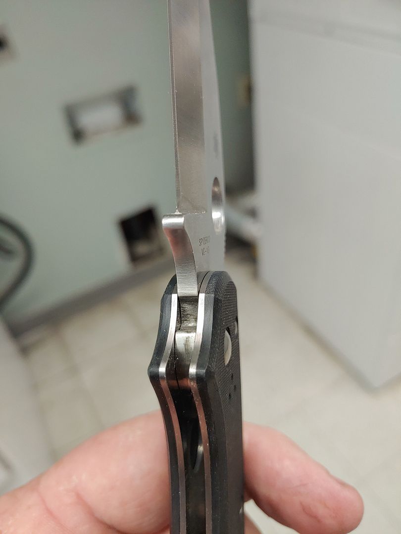

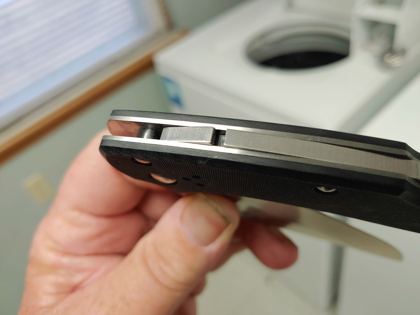

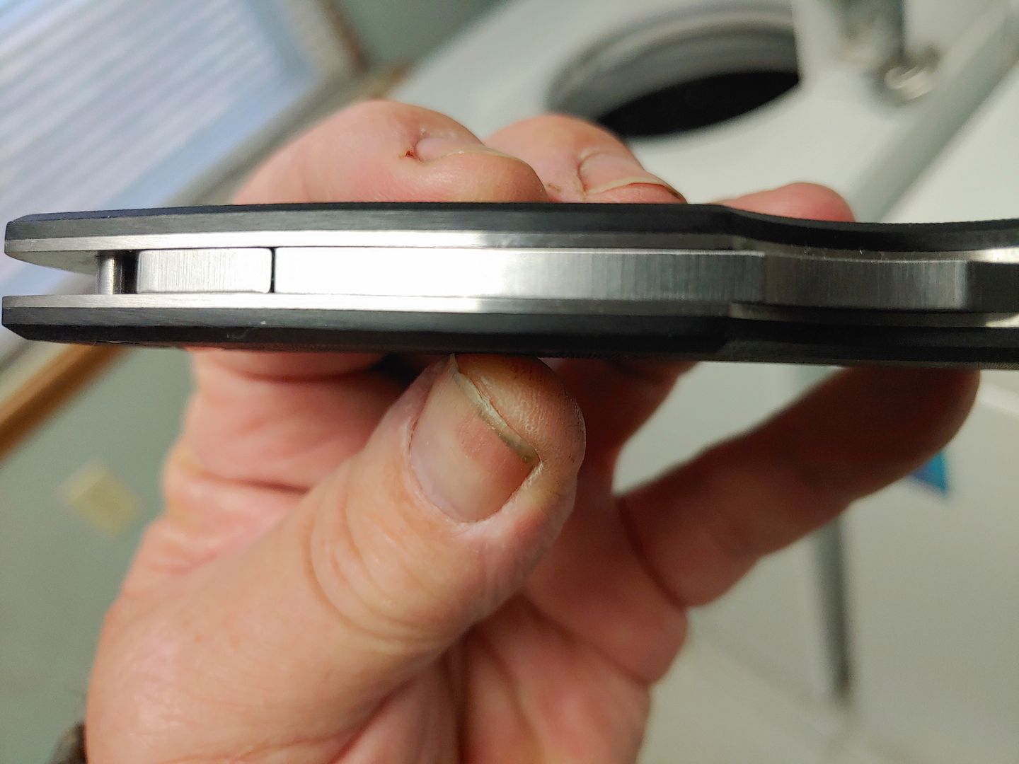

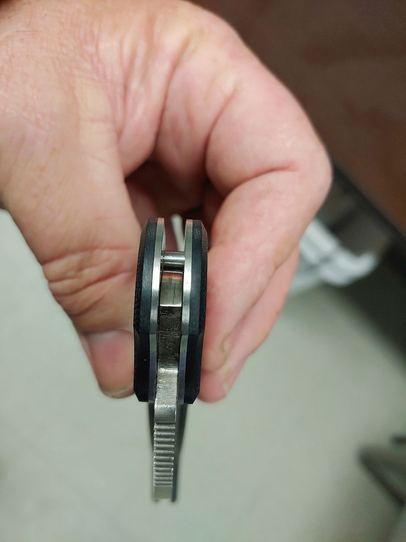

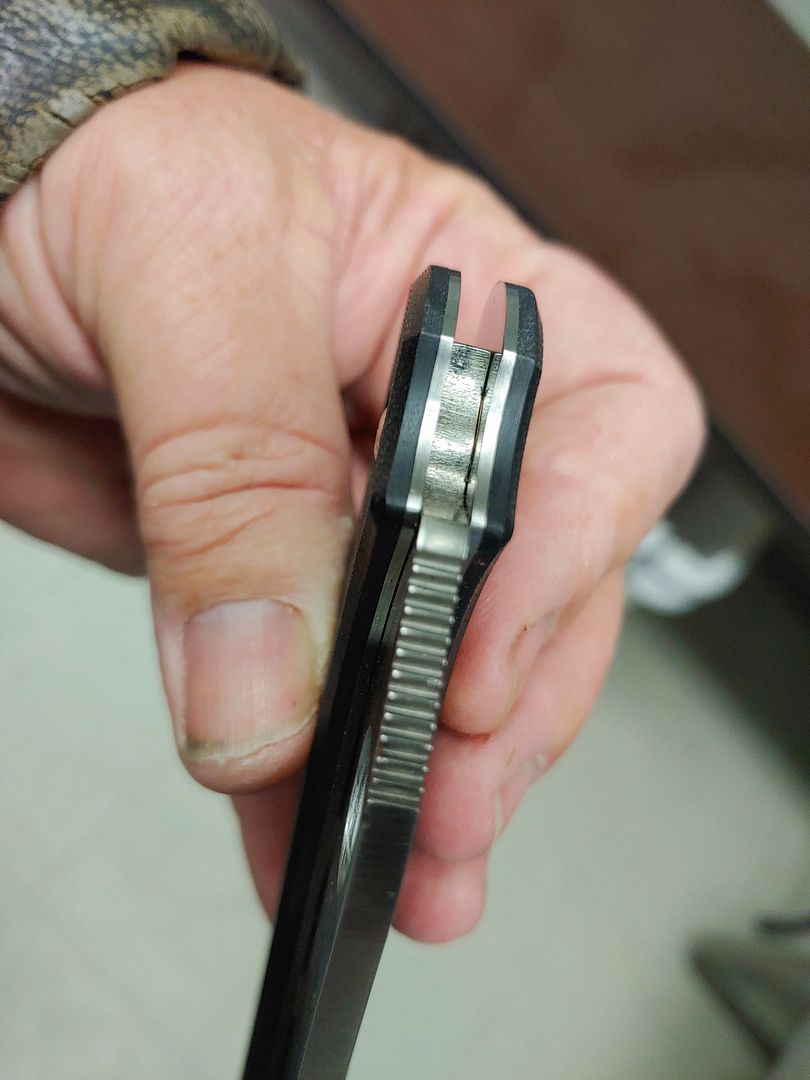

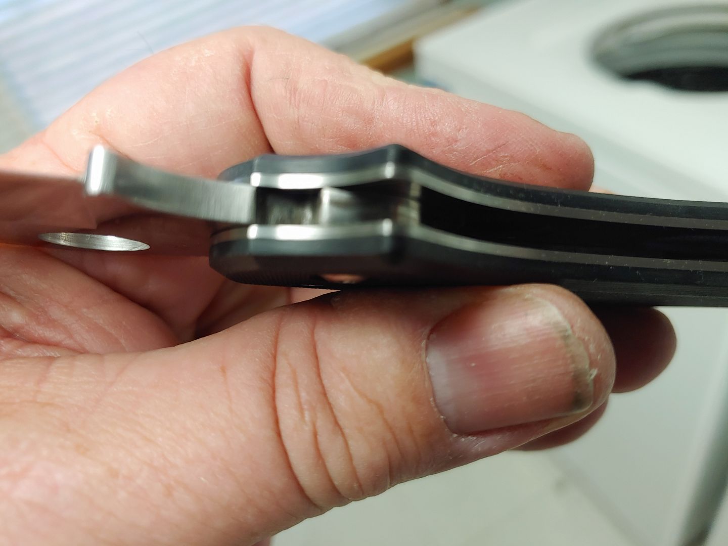

The biggest vulnerability I see is this well.
It is exposed when the knife is open and in use. Pack enough crap in there and the blade won't close all the way. It is rounded, so it is easy enough to clean out with a small stick or a stem of straw.
The second spot is here, where the toggle and release lever interlock.
Get enough sand and grit in that gap and it could prevent the lock from locking by jamming the toggle.
The gap is closed when the knife is open and locked, so a simple wipe with your thumb before working the lock would be enough to prevent problems.
The gap everyone seems concerned about is no threat. Here you can see a spot where the toggle engages the tang.
The toggle doesn't drop into a notch, it sweeps onto the tang and would push debris out of the way. Releasing the lock moves the toggle off the end of the tang, away from any and everything in the gap, so no matter what is in there, it won't prevent the lock from operating. That whole area is a smooth curve which would shed debris easily.

I haven't broken any backlocks, but I've certainly packed enough crap into various places to stop them from working. The best is when you get enough gunk stuck to the bottom of the lock bar to keep the end from engaging the notch in the tang. That can be tough to clean out. The Powerlock eliminates several problem areas of the backlock. Functionally, it is totally different, the similarity is superficial.
