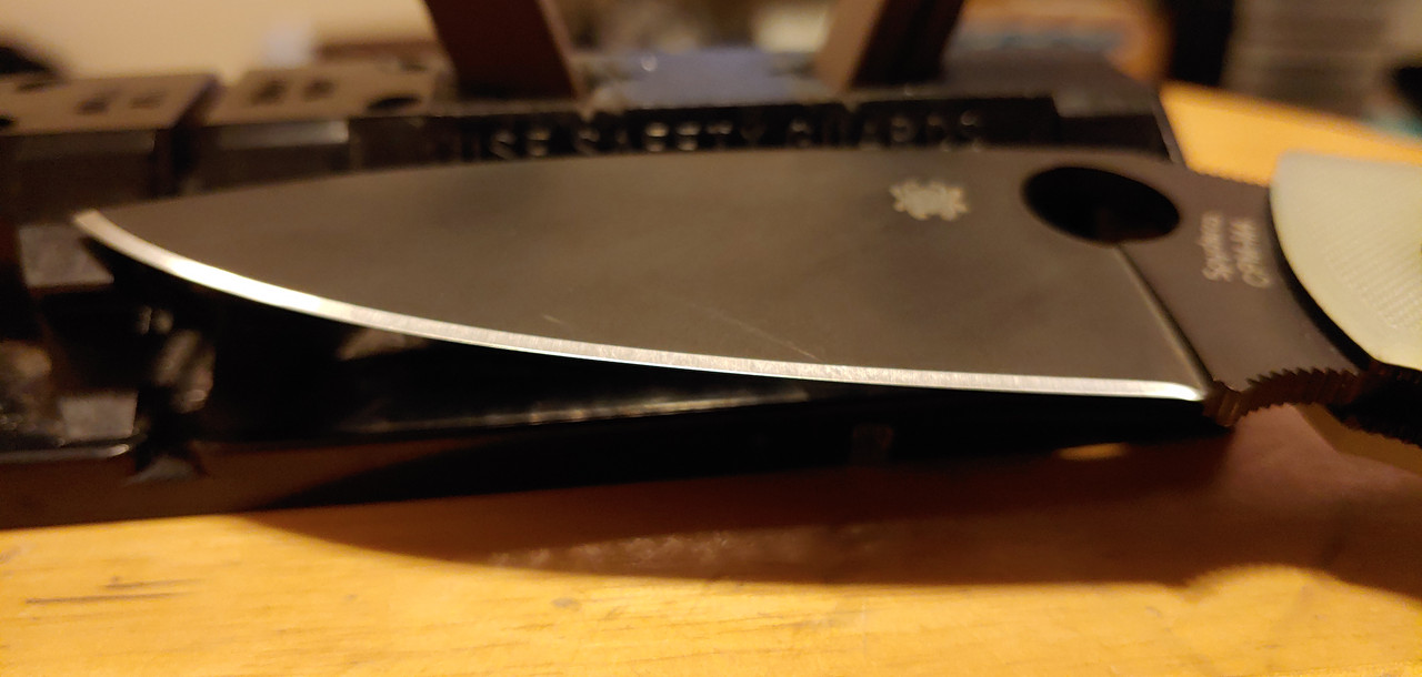

Reprofiled my Rock Jumper to 15° today. It was plenty sharp from the factory but the serrations were too pointy for my taste and would snag when cutting cardboard so my goal was to smooth it out to eliminate the snagging. Took longer than I expected using the CBN rods but it was worth it. No more snagging and tree topping sharp.

Looks good. Slightly rounded serrations like that work betterfor most things in my experience.
Posts: 13463
Re: Community Sharpening Journal
#583
Looks great! I might have to do that with my SE Wharnie Delica. The serrations are pretty pointy and snag more than I would like. I think that could be why I haven't carried it as much as I thought I would.
What was your formula for doing that?

#584
Post by The Meat man »
That looks awesome, Turbo! :cool:
How long did it take, if I may ask?
Wed Oct 07, 2020 6:47 pm
Thanks guys!
Do it! I did my Delica too and it's snag free.
The Meat man wrote:
Wed Oct 07, 2020 7:59 pm
I did it in two sessions...probably close to two hours in total. My rods are getting pretty worn down, wish Spyderco would make a bonded option of some type.
-Turbo

How many passes on the serrated side before going to the other side? Or do you wait until you get a burr? Will be my first reprofile on an SE once I get to it. Looks good though, would like to follow your formula!

Wed Oct 07, 2020 8:49 pm
Like he said it takes long enough you won't be counting passes. I'd guess at least 400-500. I've done this to more than one knife.
Yep like Vivi said no counting, just work it until you get a burr. I run a thin sharpie line along the edge and then start feeling for the burr when the sharpie is no longer visible. On the backside I use the flat side of the stone to knock off the burr.
After the serrations are done do the tip separately on the flat sides.

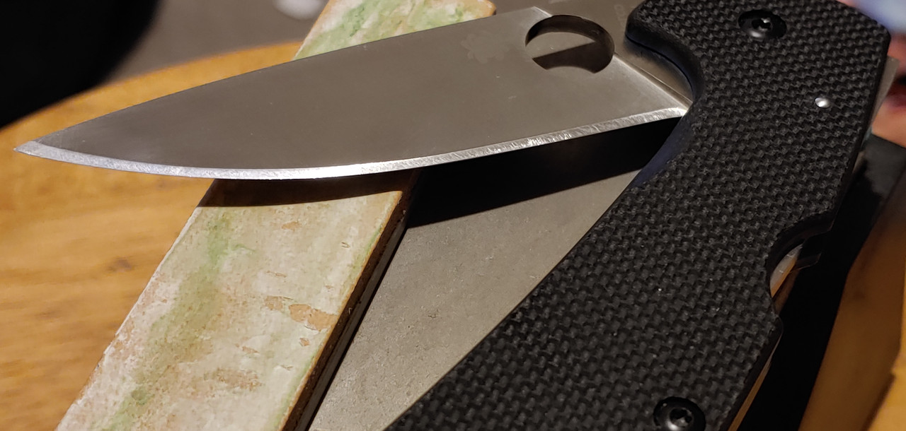

I came across this KME "The Beast" 50 grit Diamond while plundering around the net and thought I'd give it a try. I needed to reprofile my 4V mule and thought this may help with cutting thru the bevel and save a little time :eek: Oops! Took a very light sweep across my sharpie covered bevel at 13°on my Hapstone V7 and realized how deep it cut!
Laid it to the side and used my CBN tri-rods to finish the job but you can still see where the "beast" left it's mark. Hope this is visible to you, it came very close to the edge.
I left the edge toothy from the CBN rods and then took a pass or two on the SM at 20°with the white rods. It's super quiet through receipt paper without snagging, so I'll leave it there and maybe refine things out if it gets stuck in my craw too much. The Beast ain't no joke so tread lightly! :D
