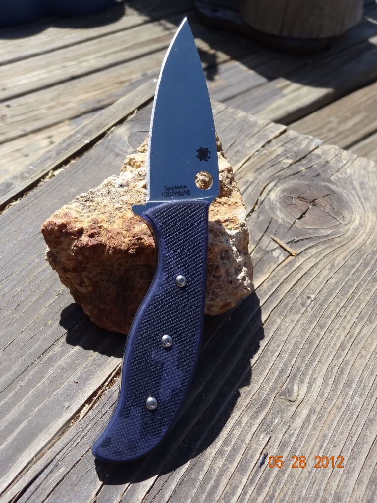

Hey, the activity on this thread has slowed down a bit lately.
What's everyone working on?
I'm finishing up a Swick 2 -putting PurpleHeart scales on it. The scales aren't very large, but that handle shape has a lot of curves to it. I'm spending a bit of time battling the splintery-ness of the PurpleHeart while trying to even out all the curves and slopes on the scales so that they feel natural in hand.
The PurpleHeart is an interesting material. Like I said, it is kind of splintery which creates challenges. It is relatively soft as well - and it is easy to cut away too much with the files or rough sandpaper. But the color is pretty amazing. The wood has darkened substantially since I've started working with it. My friends tell me that it will turn a deep dark purple over time, which would be beautiful. But for now, it is the color of black-cherry-Koolaid.
BTW, I found a great place to get natural wood scales - Bell Forest Products. Lots of interesting wood selections at good prices, and they offer pre-cut scale slabs.
I should be able to post pics of the Swick 2 sometime this week.

I like Purple Heart myself and have used it for fixed blades for a while.
In MY experience, it does not get more "purple" as it ages, but a dark brown. But that's me.
To make it tougher. and to hold it's color, stabilize it. Stabilizing will add some darkness to it, and it's hard to find clear "stabilizer" fluid. So think about that.
Here is a little home brew way of doing a few sets at a time.
Make note that AFTER stabilizing, it get's really hard to work with and will clog up sanding media in a hurry. Best to do a rough shaping before stabilizing.
This is in my experience, but, others may not share that, so, decide for yourself.

RoBo - that looks like a really cool technique. I reviewed that NCK tutorial after someone (may have been you) linked to it previously. Looks really messy, but kinda fun!
I opted for a few coats of TruOil. It doesn't penetrate as deeply as your technique, but TruOil gives you a really nice durable finish that fills in the pores of the wood's surface. Thin coat. Cure. Steel wool. Thin coat. Cure. Steel wool. Repeat.
