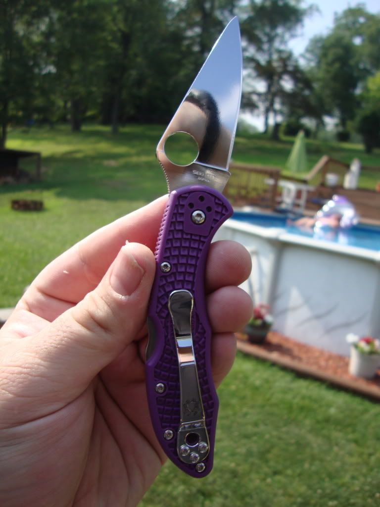

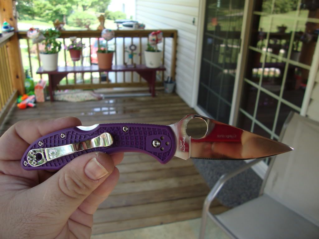

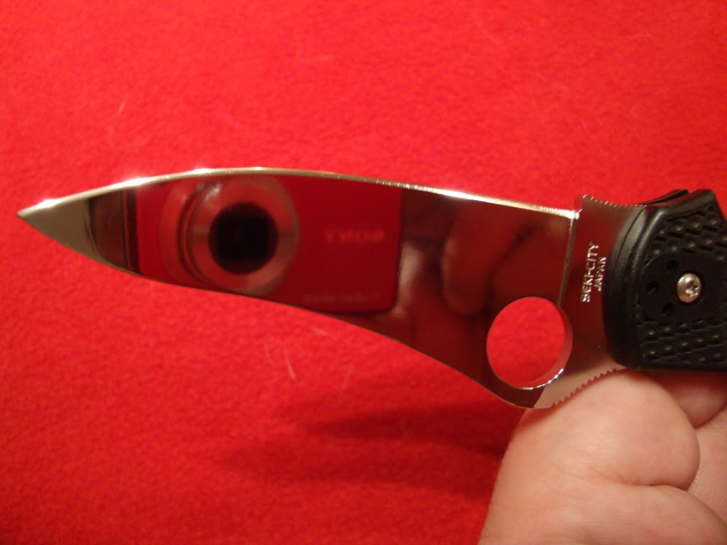

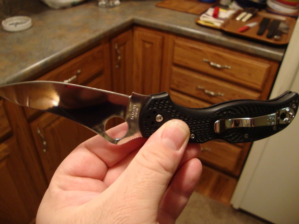

Here are some pics of a delica and stretch that i mirror polished, both the blade and clip.
I think it makes the blade look better and slice better too, plus adds more rust protection. I did an H1 pacific salt too, but its all scratched up. Overall it takes a little time, but its fun. I sold these 2 on ebay. In the future i may do more. i can make them look a little better than this now as this was like a year ago or more.
I can't wait to mirror the new manix lightweight or another knife that i think would look cool mirror polished.
What knife you guys think would look great polished like that. What i usually do is after using the knife how it comes for a year or so; when it starts to look worn down and paint is coming off the clip i'll polish it. (Edited)

That looks amazing! What did you use to achieve that mirror polish?

cheapmovies25
Posts: 4
Joined: Tue Nov 08, 2011 12:44 am
Location: Near pittsburgh
#560
Post by cheapmovies25 »
