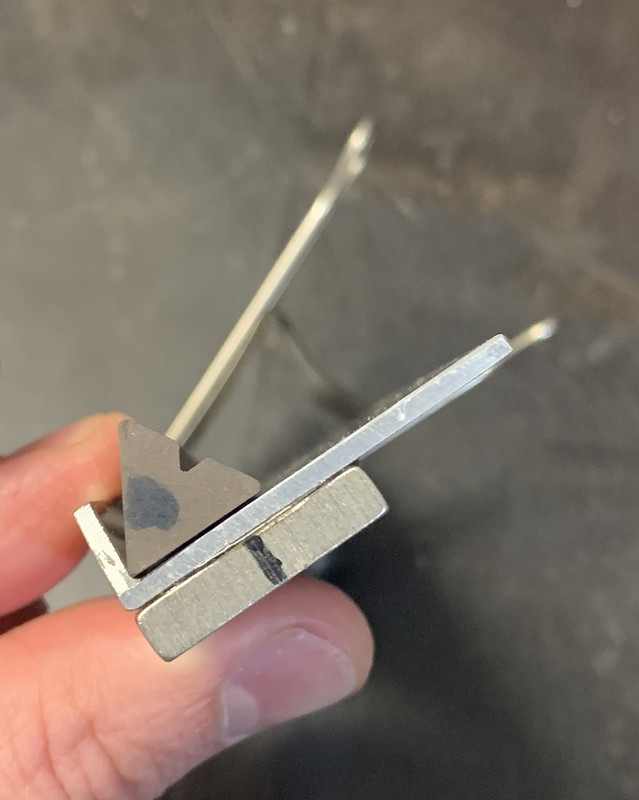

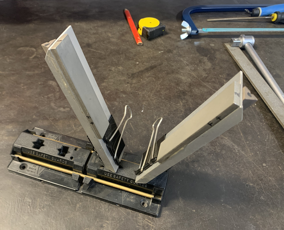

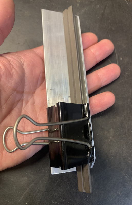

Guts wrote:
Tue Jan 28, 2025 8:51 am
...with some rubber bands you can just attach a small diamond stone, something like a 6x1" stone from a guided sharpener for example, to the flat side of a sharpmaker rod.
Nice!
I did a similar thing years ago. I use it for micro bevels on high carbide steels.
I had a set of DMT Diasharp Fine diamond stones lying around that I wanted to use. I mounted them on alu angle bar, and used a set of strong paper binder clips to attach them to a set of worn-out SM med stones. The stones are a bit short at 4 inches, but they work, and I like the finish of the DMT Fine grit for relatively coarse edges.
I should really make a 6 inch version this weekend... I already have spare Edge Pro 6 inch stones. Thanks for the idea.
