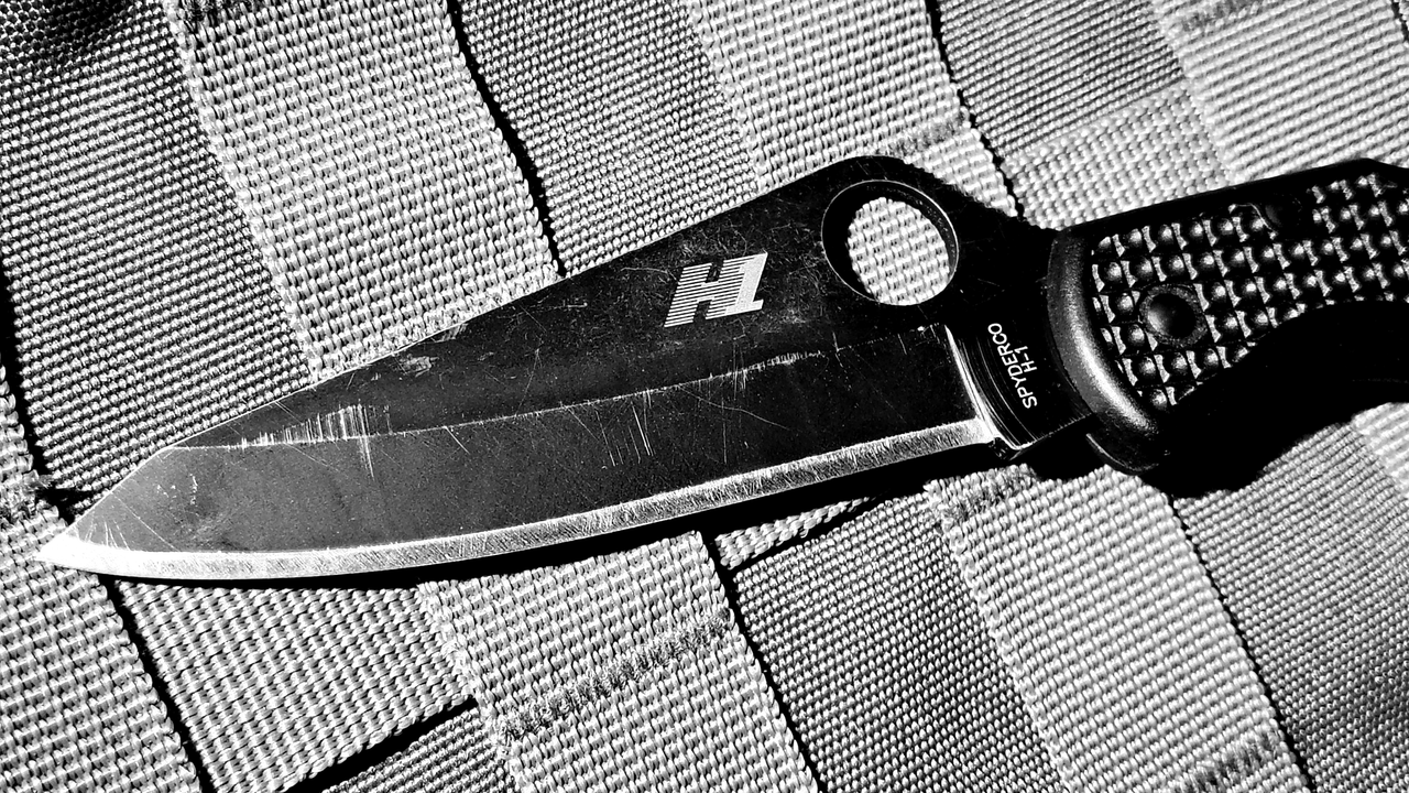

Curious...as someone who is contemplating getting more into SE knives, what were your thoughts regarding moving away from them? Thank you for any thoughts you have.
For me taking a plain edge thin and giving it a coarse apex has the same advantages (longer edge holding, grabs materials better so they don't slip off the blade) without the disadvantages (can snag on a lot of materials, requires more specialized sharpening equipment available in fewer grits, requires more of a slice when used against a cutting board etc.)
In my experience no matter how a SE has been sharpened or what type of serration pattern is used it's a lot more likely to snag during cuts than plain edge. Whether it's deep jagged serrations like a Kabar TDI, small shallow Victorinox paring knife serrations, or spyderedge. Any of these taken to a hair whittling sharp edge will snag on certain materials more than my PE blades.
Most the benefits of SE for my uses come from the edge geometry, which I can easily replicate on PE.
There's no real getting around the sharpening limitations. There are so many more options in terms of abrasive type, grit etc. for sharpening plain edged knives. I have a large toolbox full of sharpening stuff that only works on PE knives. Not to mention they need reprofiled by hand while any PE knife I can take to my belt sander to save me time.
Back when I ran polished edges on everything I fell in love with SE H1 for offering much better edge retention than PE H1. But when I discovered I could quadruple the edge holding of PE H1 simply by changing how I sharpen it, that benefit was lost on me.
YMMV but that's enough edge retention to satisfy me.
At the end of the day SE knives take more time and effort to get the edge where I want, while not offering me benefits over a thin, coarsely sharpened plain edged knife. If they did certain things much better I'd carry them but there's no significant reason I have found for my uses to carry them over PE.
i totally forgot about these videos. i finally got some pe h2 so i could see how it stacks up to se, but never tried thinning out the edge or leaving an intentionally coarse edge. i have noticed it's super easy to get an insanely sharp edge, but i'll have to try this out now.
I'd recommend it. This is one of my favorite work knives:
vivi have you tried the same coarse low angle edge on the LC200N version of these knives? I'm curious if that performs close.

Happened to come across another quote by Larrin Thomas about how superior SE generally is over PE when it comes to edge holding, thought it might be of interest:
"I have only tested one serrated knife and that was one in VG-10. It never dulled over the course of the test (even with the longer test for serrated blades). So I lost interest in testing serrated blades. Just waste a lot of my test media." (viewtopic.php?p=1487341#p1487341)

sal wrote:
Mon Dec 23, 2024 4:33 pm
Red Leader wrote:
Mon Dec 23, 2024 9:30 am
How was that tested, and how was it measured?
CATRA testing.
Sal, thank you for taking time to respond. Any chance you would be willing to divulge the details of the results, like number of cuts? Also, have there been any other tests of other SE Spydies? Is the stellar result of SE H1 from it outlasting all other steels, or simply being the best tested up till this point, with many still yet to be tested? I'm curious to know if the result of SE H1/H2, comparable to Rex-121, is more about the steel, the SE, or the combo - and being able to compare the results of CATRA testing of SE H1 to the results of any other SE steels could prove instructive.
For example, if SE H1 tests so well, could we see even more amplified results from a steel (like K390 or M398) that is better known for good edge retention? Based on Steeltoes83's cut tests, I'd love to see more exploration of M398, given its killer performance.
More wishful thinking: If a modified Spyderedge with even smaller serrations and less acute points were developed, could we even see a SE on Rex-121, as another poster mused about? If scientific testing shows a more favorable edge stability (i.e. less chipping) from serrated versus plain edge (linked article referenced by @Wartstein above), could a steel like REX-121 actually be the ideal steel for Spyderedge, if the serrations were tuned just a bit for that steel?
It's pretty fun thinking about these these, especially with the goal being absolute maximum edge performance. Also thank you for taking such an enthusiast-minded perspective on these topics. One of the main reasons I gravitate to Spyderco.
