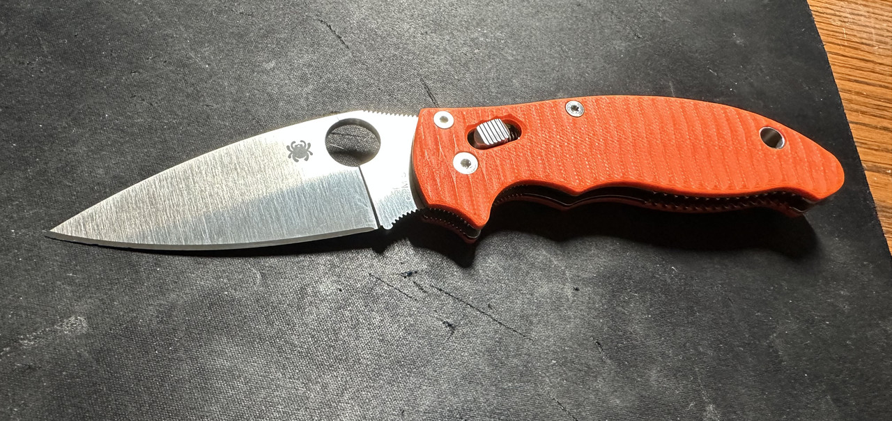

Thanks for the good info, Shawn. It makes perfect sense. I should have never chose a Manix 2 with its very thin factory edge.
I dabbled in freehand sharpening and love convex edges, but I could just never form that bur well enough to get the sharpness I wanted. I moved to a KME sharpener a few months back and am getting nice, screaming sharp, edges. The problem is, I've lost the ability to convex the edge like I could freehand sharpening. Im not able to get those beefy edges that I like. I think Im just going to stick to a thick stock edge like that found on the Shaman. I have several of them already. Let me know if what else I need to keep in mind. Thanks.
Just increase the edge angle setting on the KME.
You'll still get your flat crisp edge just start at ~22dps and see how that works for you and adjust accordingly through use.
Personallize it, make it yours.
The factory edge is a place holder, it's not a constraint we are forced to adhere too.
Do you think that it makes more sense to use an obtuse edge on a steel with high wear-resistance? Kind of how people suggest that you should take advantage of tough steels by putting an acute edge on there. To me it would makes sense that while the more obtuse an edge, the more wear-resistance goes down, but the high carbide content would mitigate that and allow a more obtuse angle for increased edge stability. On the other hand, it seems that a more obtuse angle invariably means a thicker apex and perhaps less cutting ability? As with all things, there's probably a sweet-spot, but it makes me wonder if that sweet spot is higher for carbide rich steels, and lower for low-carbide steels.
Absolutely not.
The end user is the biggest variable of all.
Dr Vadim Kraichuk would advocate for ~13dps on high hardness, high carbide volume steels sharpened with a hollow edge on his Tormek using cBN wheels.
I personally like sub 15 dps edges, but it's not a one size fits all experience for everyone.
Also, it's not just carbide volume that determines stability but the matrix that surrounds the carbides.
We need to remember the knives don't cut by themselves. They have handles on them, so the end user decides the outcome.

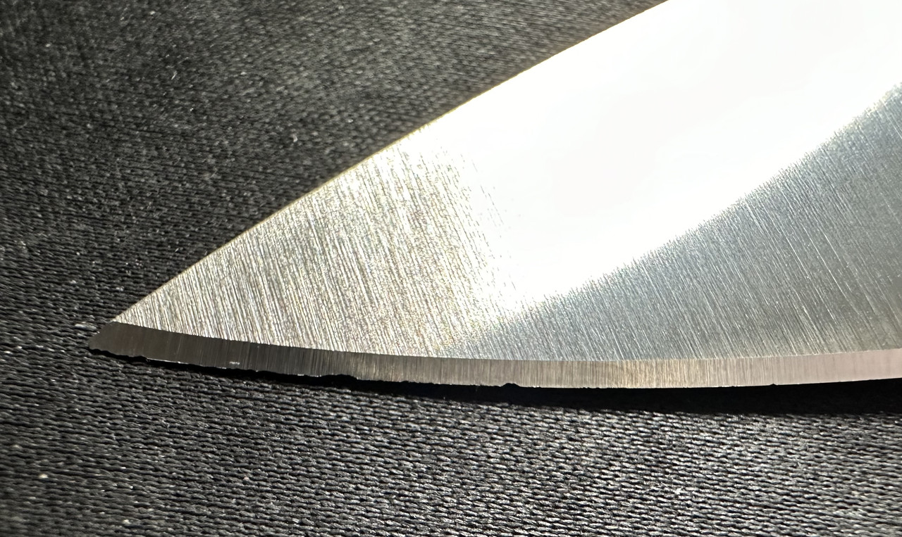

jmj3esq wrote:
Sat Dec 09, 2023 6:36 am
I kinda built this Manix 2 for a hunting knife option to use in the field gutting and dressing game, especially deer. Well I finally got to use it when gutting a doe this morning. The blade zipped through the flesh with ease, but when it came time to cut thru the sternum we had a problem. I could hear the blade crunching against the bone and cartilage and it immediately popped in my mind that S110V chips easy. I got thru it with no problem, but the blade got trashed. Major chipping towards the tip of the knife. Considering this was my first use, I’m not happy. It will sharpen out easy enough, but I should have never picked S110V as my steel choice, or the Manix 2. The steel isn’t tough enough and the blade is too thin to use on larger game. I think a Shaman is the way to go. Just not sure what steel would be tough enough for these hard uses. Anyway, I just wanted to share my experience with this knife and steel. I love the Manix 2 and personally have 6 of them. They just won’t be getting used for hunting purposes anymore.
Do not rule out the knife yet.
I would not do the task you did with any CPM stainless steels other than MagnaCut. Even MagnaCut might have chip in that situation.
However, before you give up on S110V, sharpen it deep enough to take out all the chips. Hopefully that will remove enough steel to reveal the real performance of the steel. And then put 20dps micro bevel on the edge.
If that does not work, sharpen your knife to 20dps and put micro bevel at 25 dps. If that does not work, sharpen the knife to 25dps and put a microbevel at 30dps. At some point you should get an edge that will not chip. When you find that geometry which takes the abuse decide if the knife still cuts good enough for you. If it is that problem solved, if not, then it might be the time to move to another steel. You might get some small micro chips that might be stropped out with a good quality strop that is normal. However, If you still get chips large enough to not get fixed by a good strop, then it is time to find alternative steel/knife for the task. LC 200N would be great steel to resist chips.
The instructions you provide will make this knife more of a 'knife-like object' than a knife. That is cold-chisel geometry you are describing and it's quite extreme in the context of a knife which will not be subjected to chisel cutting metal. You can do this, sure, but I would ask to what end when you can simply get a more suitable tool for the job given in the OP? Simply moving to a low carbide volume steel would yield much better results in that it's likely to result in a rolled edge at worst rather than significant chipping.

I'm not upset, I certainly didn't mean to give that impression if it comes off that way. I just don't see it as a valid recommendation in any case unless you are cutting metal by hammer blow, etc. Those are cold-chisel geometries and have no place on a knife of any kind, IMO. Therefore, if the steel is so brittle as to require such geometry in use such as this then I question the validity of the steel in the first place for knife applications considering it seems to lack minimum durability.
My concern is that this type of recommendation is common (just make it more obtuse) and taken out of context it can easily mislead many people into thinking it's a good idea. As I said, the use case for that geometry is extremely narrow and I don't see really any current Spyderco's as having the correct design parameters to fit that scope of work. As you said it is a challenging task for a knife but again the OP seems to have already learned the lesson that the steel is a poor choice here.
It's not just cutting performance but also edge retention that is reduced by taking the angle so obtuse. The irony here is that S110V is one of those steels that is said to be one of the 'highest edge retention' steels. The interesting thing is that it seems it requires such obtuse angles as 17+ DPS to not chip extensively. This will reduce the actual edge retention dramatically and bring the performance of the steel down to a much lower carbide volume class anyways, so to what end?
The effect of lowering edge angles can have such a dramatic influence on edge retention that even lowering the angle by just 2 DPS can cancel out added wear resistance. So in this way you can have not only a tool with dramatically higher cutting ability via lower edge angles but ALSO dramatically higher edge retention if you are able to optimize the edge angle and reduce it dramatically compared to the factory standard. Wear resistance is not the only way to boost edge retention.

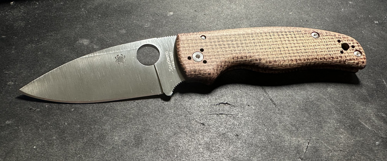

Finally got the time to reprofile and sharpen the chipped up S110V. The chips were ground out quite easily.
I won’t be using this knife for any further game processing. I think it’s time to gain the courage to actually use my S90V Shaman for game cleaning purposes. I think it’s built for it.
Here’s what I’m going to start using.
