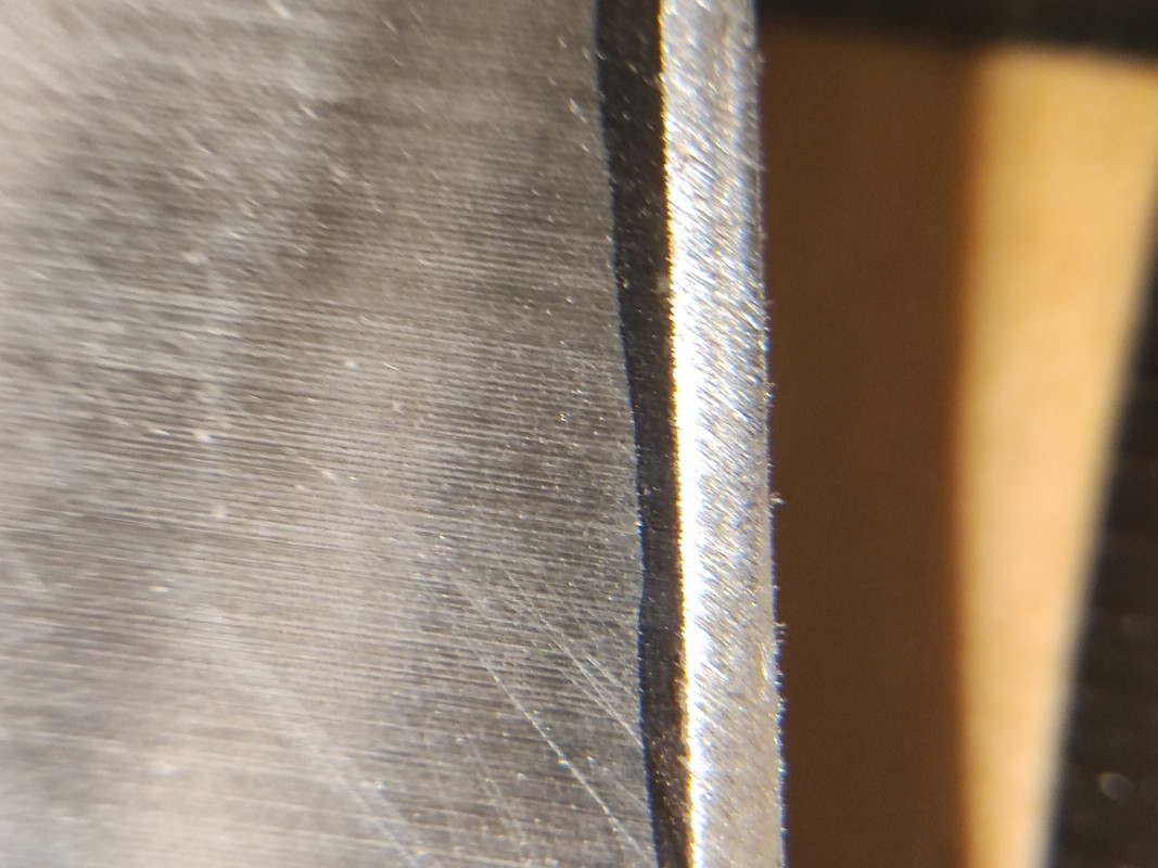

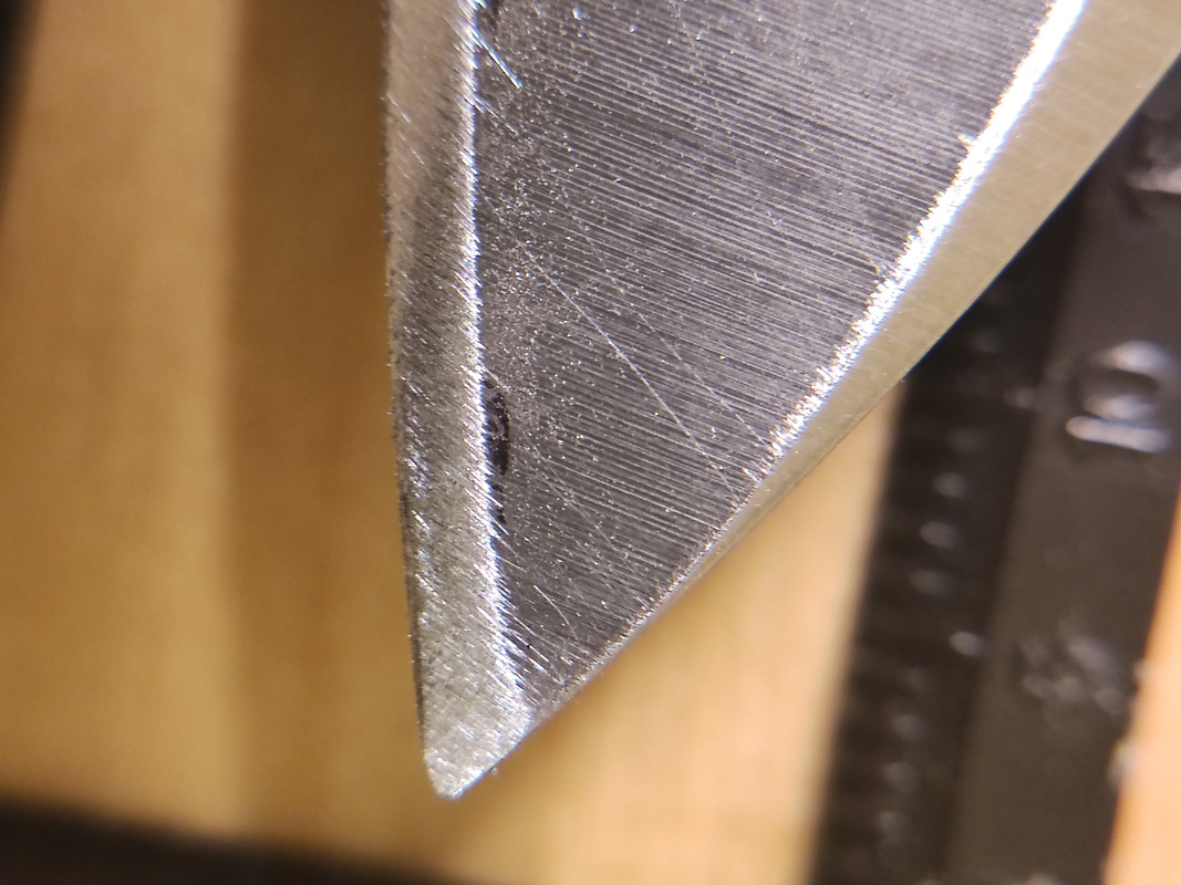

I'm just in the middle of sharpening/ reprofiling my Aqua Salt, so here are some pictures!
Fresh edge of the diamond rods
Here next to the tip still needs more work. The painted edge really helps with the identification of areas where the apex hasn't been reached.
Primitive technology :winking-tongue

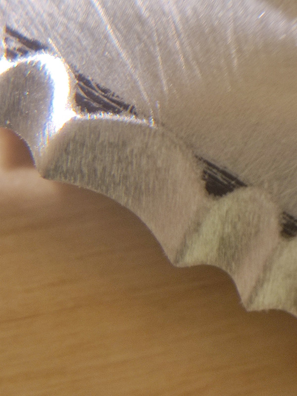

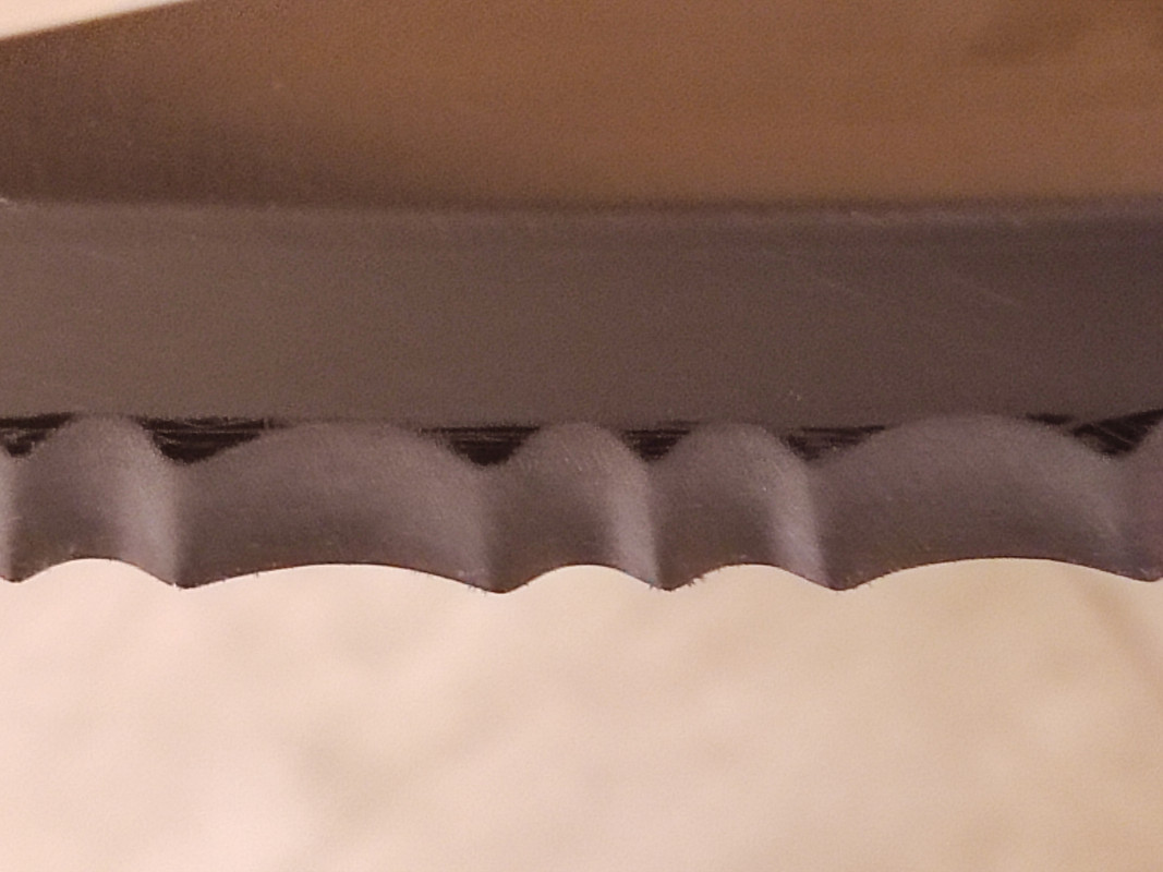

tonijedi
Posts: 1198
Joined: Wed Oct 03, 2012 10:08 am
Location: Portugal
Re: If you are NEW to sharpening, or having DIFFICULTY, YOU NEED TO SEE THIS THREAD
#52
Post by tonijedi »
Salt 2, 15dps, sharpmaker diamond rods:
It's still possible to observe the "dust" from sharpening on the diamonds.
