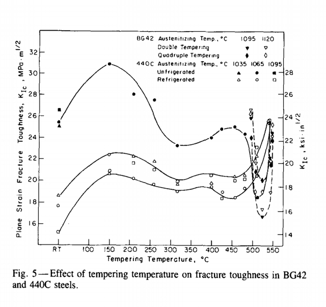

In an effort to actually discuss the properties of the materials, in regards to fracture toughness, steels don't have a simple relationship between hardness and toughness, the reason why this often appears to be if you look at data sheets is that you are getting a very selected data set. Imagine for example looking at the NBA, you could easily pick out ten people and create a group where the best players were ranked in height, but this is artificial, it is easy to understand that while height is a factor, it is only one factor.
How does toughness actually depend on hardness - well that isn't a trivial question because the reality is that it doesn't. Both of them are influence by the microstructure and some factors can increase both properties, some times one is increased and the other decreases, thus in general, well you can't really generalize. It would be like asking are Sal's designs better than Eric's. It would be a hard question to answer because you would have to define better and then how to measure it. If you attempted to do that you would quickly realize both are likely quality designers and bring different things to the approach.
How are toughness and hardness related, well here is some actual data :
This is from "The effects of heat treatment on fracture toughness and fatigue crack growth Rates in 440C and BG42 steels", Bingzhe Lou, B. L. Averbach .
The interesting thing about this graph is that it shows two very strong embrittlement effects very clearly. Note what happens in tempering at about 300C, the toughness goes to a minimum. In fact as you increase the tempering temperature from 150C, the toughness keeps decreasing even though the steel is getting softer. The toughness is actually highest when the steel is the hardest. The reason this happens is well known, it is called TME. BG-42 has an even more dramatic effect when it is tempered at 525C, note how the toughness goes to a drastic minimum. But the interesting thing here is that in this case the hardness is increasing as you increase the tempering temperature from 475C to 525C. Now the hardness is increasing but the toughness is decreasing, the exact opposite of what happened previously. This is also well understood and it is processed called secondary hardening.
If a steel has a high Molybdenum and/or Tungsten then it will have the kind of behavior that is seen in BG-42, thus 3V has it as well. Almost all steels have the embrittlement effect at ~300C which is shown in 440C. There are ways to stop it, for example Silicon inhibits it (as it prevents cementite precipitation), this is why you see Silicon in high toughness steels as it allows higher tempering without getting into TME.
That graph also shows the dramatic effect that extended quenches have on a reduction in fracture toughness, this is also well known and it is do to the phase transformation of austenite. Thus if you want an ultimate tough steel you might not want to use cold treatments.
Now as for 3V, it is an interesting steel which attempts to bring high toughness and wear resistance into the same steel using the principle that Crucible championed in the late 90's which is to eliminate almost all carbide except MC carbide. Is it a good folder steel? Well it depends on how your folder blades are failing :
