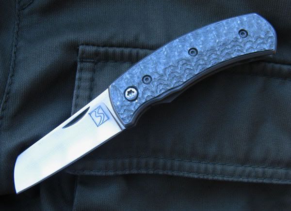

SANDBLAST!!!!! Dont think, just blast it!!!
It looks better and feels better. What Sand blasting does is eat away at the resin, but leaves the fiberglass, so it creates a layered look, that I think looks even better on G-10 that is layered to begin with.
Check out this photo, this is blasted Silver G-10 and you can really see the layers and I think it gives a a subtle layer of depth.
I sand to 120 before blasting. If I were to not blast it I would sand to 600.
