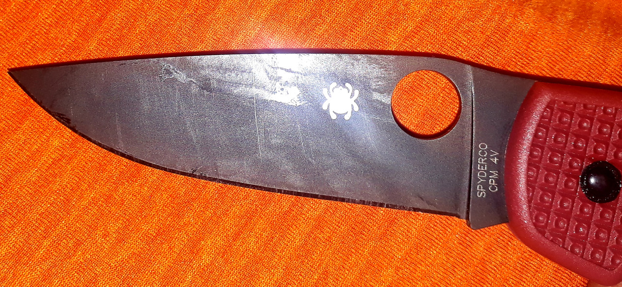

Here is my only complaint. It's minor and doesn't affect usability, but surprised me as I've never seen this in a Spyderco blade - I bought two, and both were the same:
My Caly 3.5 came that way almost a zero edge grind near the tip. I fixed it, but yeah it happens.
Same here, well, the one I have was pretty bad but the other one was not that uneven heel to tip and side to side. As long as the primary bevels are symmetrical I'm all good. Here's my solution for this afternoon :winking-tongue :
I don't know if it can be seen but it's pretty homogenous now. It took more than an hour because I was watching a show at the same time, and it Might have distracted me :squinting-tongue

These lop-sided edge bevels seem to be Seki's MO lately. My Goddard is maybe a little bit less shallow at the tip on the one side, but looks much closer to yours than perfect. My knife still arrived very sharp, so I guess I can't complain too much..

Well, thanks to Robin / Ramonade who helped me out with ordering (and even forwarded the one with the better grind of the two he ordered to me!!) I have one too now... and love it so far!!
Carried it for a day now, and I think the blade shows that I used and tested it quite a bit already in that short period of time ;)
that’s probably the most beautiful one day old Goddard I’ve ever seen!
Thanks! :smlling-eyes
I like how the coating shows use, "history" and "life" of the knife pretty well and pretty soon!
Still I am considering to remove the coating: Makes no practical sense for me (except perhaps at the pivot area where I´d keep it anyway) - the blade won´t ever corrode in a way that could have practical implications in my lifetime even without coating, and I like the way tool steels "patina"
