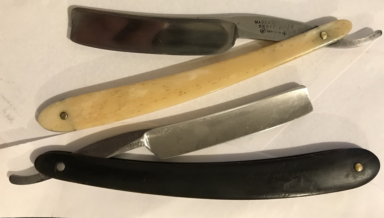

I think I'm starting to favor the thick & heavier razor grinds, no thinner than 1/2 hollow.
They say the thinner grinds get sharper and shave closer, but I haven't found that to be the case. Maybe my sharpening skills aren't there yet.
As for sharpening/honing/stropping, the thicker blades are less prone to flexing the apex away from the stone/strop, so pressure used is less critical. The thinnest blades are very flexible and extra care in how much pressure used is mandatory. I typically don't use much more than blade weight for my thinnest blades.
For this reason, I feel the thicker blades are easier and faster to sharpen and keep touched up.
I'm also not too fond of the scraping sound thin blades make while shaving due to the blade flexing during the cut. The thicker the hair, the louder it is. I suppose the ultimate sharp razor would be a very thin blade being silent while shaving thick hair, but again I'm not there yet.
From left to right, thickest to thinnest, wade & butcher, Wostenholm pipe, Colling, Wostenholm IXL, Erik Antonberg.
They are all hollow, the difference being how high the hollow is ground.
I suspect the W&B might have originally been a wedge or near wedge from the factory and later hollowed. This would explain the unevenness in thickness.

All of mine are full hollow ground, but the Colling has that belly/horizontal stabilizer near the cutting edge and it really makes a difference in the blade feel. I still get that very thin grind, but I also get more stability from the blade. The blade is confidence inspiring. Try one of his like this and you'll be a believer.

From what I've read, there seems to be two popular interpretations when describing the degree of hollow grind.
1. Depth of the hollow only, with no regard to where on the blade the hollow starts, whether its at the apex or higher up the blade.
2. How high above the apex the "hollow" starts.
Using #2 gives me a more accurate visualization.
At this time, I'm very satisfied with my Colling.
If I were to get another, I'd request a 5/8 height, near wedge or 1/4 hollow, with slightly curved spine and belly. If this isn't doable without going custom, straight is ok.
I think if Spyderco (or Colling) made one with a grind like the 2 on far left pictured above (or my description above), it would be the perfect razor for me.

jpm2 wrote:
Sat Jan 14, 2023 1:48 pm
I've never tried a thicker razor but I like how they look. I'd think the main thing that would matter with a straight razor in terms of cutting ability would be how thick it was behind the edge. I'm not sure why 1/2 hollow vs full hollow would make a difference in that case. Maybe it lets you follow the contours of the face more easily.
The razors on the left look like they have a curved blade. Does that make them harder to hone?

vandelay wrote:
Sun Jan 15, 2023 3:19 pm
Those are among my favorite and best shaving razors, along with the boker red injun and colling. I think it makes them easier to hone due to not needing a "dead flat" hone. It also allows for the natural rolling stroke that occurs when freehand sharpening.
If you take a close look at most vintage razors, they were made with a slightly curved spine. I think they are designed this way so that the edge devolopes a natural outward curve when honed. It's important, that you don't hone even the slightest inward curve to the edge, what's commonly called a "frown".
The only razors I've seen that have a straight spines are newly manufactured ones, like the Colling.
As for ability to cut, let's say a beard hair is 200 microns in diameter. That's 8 thousanths of an inch. I'm pretty sure the bevels on a full hollow 16.5 degree edge are wider than that, so it's a moot point how thick the blade is past that. Even a wedge should cut as easily as a full hollow, actually better due to a more stable blade.
The more hollow ground a blade is, the more it will bend and flex, both when cutting and honing. Having a belly just above the edge that Doc talks about can help with that. His is the only one I've heard of having that, none of mine do. Otherwise, the more thick, and less hollow the blade is ground, the more stable it is, given the same height of blade.
They say the thicker the grind, the less trouble shaving thick beard. My beard is average and I can tell the difference.
