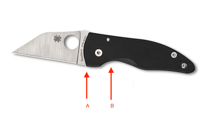

Where is the index finger supposed to locate, on a MicroJimbo? At point A or B? I'm sure you could do either, but for which location was the MicroJimbo designed? How does Mr. Janich hold it for its intended purpose, index forward (A) or index back (B)?

"B" has to be the spot. The idea of the design as I understand it is to keep the same cockpit as the Yojimbo 2. Like how Glock did their mini Glocks back in the day. I think the handle on this guy is just coming up a little bit short. Although I have not had one in hand yet.
Dear Bolster:
For my purposes, typically B. If I'm using the knife for detail work, I typically choke up and put my index finger on the back of the blade.
I purposely made a but of a paradigm shift in the design of the MicroJimbo by incorporating a shorter handle and a deep-pocket clip. To be completely honest, if I'm only concerned about blade-length restrictions (like when I travel to Chicago and Boston), I carry a ChicagoJimbo--a full-sized Yojimbo with a bobbed blade. These are reminiscent of the blade-to-handle ratio of the original Yojimbo and the Kahr Arms Delica; however, many people who can't relate to or don't care about blade-length restrictions don't "get" this approach. As such, it's a very limited audience.
For the MicroJimbo, I achieved the target 2.5-inch blade length, but also shortened the handle and added the deep-pocket clip and a full-flat grind. I did that for several reasons:
Critics of the Yojimbo 2 (most of whom have never owned or handled one) claim the hollow grind makes the tip too fragile. The flat grind addresses that.
Some people insist that deep-pocket carry clips are a necessity. In reality, it's a balance of knife size, hand size, and clip position, as I've explained before on this forum and in the byte newsletter. The Micro's deep-pocket clip works--because of the smaller handle size.
I have a growing number of female MBC students. The Yojimbo 2 won't fit in the pockets of typical ladies' pants, but the smaller handle of the MicroJimbo will. In fact, some of the ladies at Spyderco have already embraced this and become MicroJimbo converts.
With all that said, I know the MicroJimbo's handle doesn't offer much of a home to your pinky. Neither do my .380 and pocket-sized 9mm pistols or my J-frame revolvers with concealable grips.
Life is a balance of priorities and compromises... Fortunately, Spyderco has given me the opportunity to offer a range of choices as well.
Stay safe,
Mike
