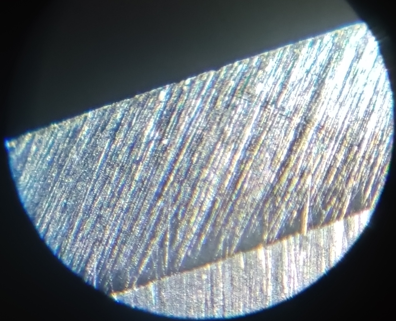

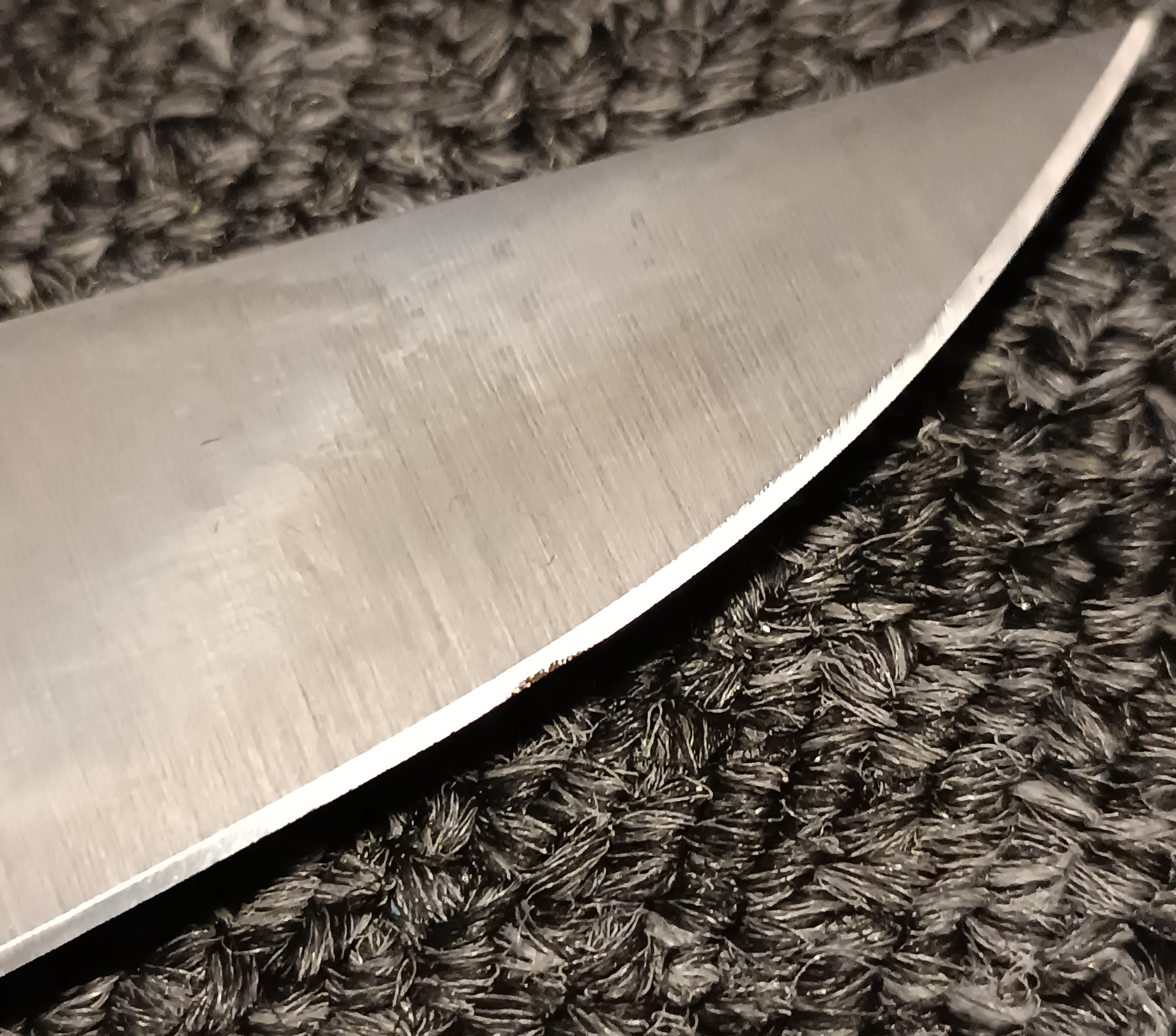

2 more years of the same and other than touch ups, haven't tried to clean it up since.abbazaba wrote: ↑Wed Apr 27, 2022 9:22 pmAs an experiment, my S110v Manix LW has been my swim shorts knife for years of yard work followed by soaking in the pool, and despite straight up abuse the blade looks great. I think this was the 4th year in a row it's lived in my swim shorts all summer, remaining wet for hours/days in the shorts pocket hung up after swimming. We own a pool and a hot tub so its fully submerged and left wet almost every day during the summer. The spring and ball are fine (btw), but the backspacer is covered in surface rust. I hope Magnacut will do as well or better because S110v isn't my favorite edge, but its been better than LC200n and H1 in this specific situation for me. Still hoping for that Manix2 LW Salt!
Pics of S110v after 4 years of swimming in the pool/hot tub, left in wet shorts after:
After 30-60 seconds of fingernail/thumb rub:
Inside was a little more difficult, so I used a flat head to get in there, again only 30-60 second attempt:
Before:
After:
FWIW, my 15dps reprofile held up as well as rest of the blade, with minor touch ups through out. S110v loses it's fine edge pretty quickly IME, but it does continue to cut for a long time... I just prefer a tool steel type edge (M4, K390). Hoping Magnacut lives up to the hype!
