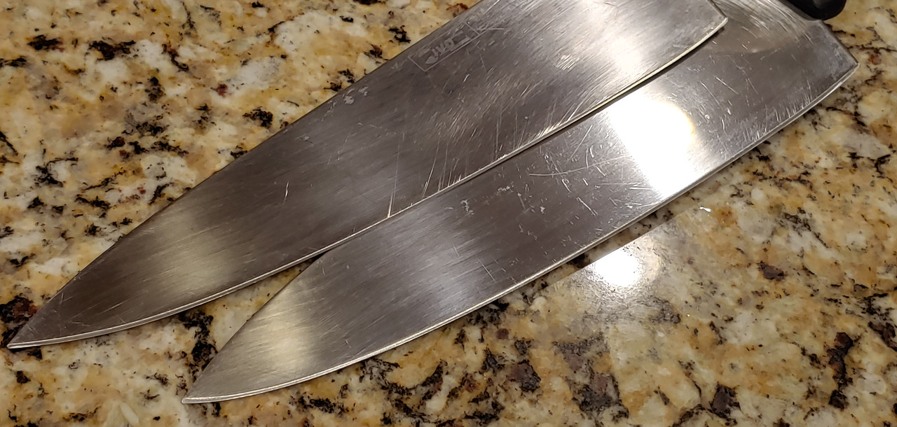

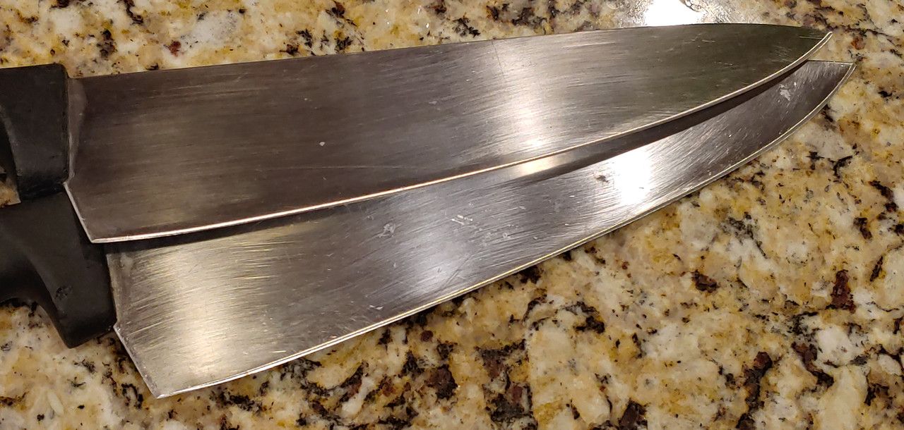

Today I took a couple of beater chef knives to my belt sander. Bad pictures and I'll probably play around with the edges some more tomorrow, but these boys will cut circles around the knives I was using this weekend even as they are now. I gave them a few licks on a ceramic rod and they'll cleanly slice paper and take off arm hair, so they're getting there.

Nice work Vivi. I’ll be looking forward to your report in the Community Sharpening thread. :)vivi wrote: ↑Mon Sep 28, 2020 7:33 pmI'm going to have to try z cuts some day. They look like they'd be nice for camping. I think whenever the Swicks or LC200N Pacifics drop I'll add a pointy Z cut to my order. Maybe two so I can get one in each edge type.
After realising the hard way that most people just aren’t equipped in their mindset to properly use or maintain decent chef knives, I often buy cheap ones with decent blade shapes and handles from thrift stores, or op shops as we call them here.
I’ll give them a similar edge to you - thinned out and cleanly apexed on a coarse diamond stone, then a few passes on the brown rods and maybe a light strop with a diamond emulsion pasted strop in the 10-7μm range.
When I give them to people, they usually comment that they’re the sharpest knives they’ve ever used.
They dull fairly quickly, of course, but it’s very quick to resharpen them with the same process again.
Despite the cheap mystery steels and heat treats, I find the technique is a useful confluence of maximising edge retention by using acute angles, relatively coarse finishes, and thin behind the edge grinds.
