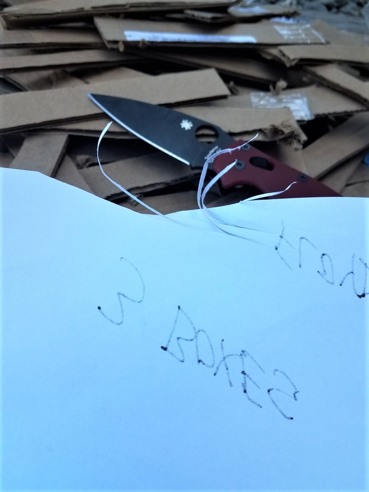

I used the 52100 Manix for the week last week. As I expected, it lost its initial peak sharpness rather quickly and after 3 days of use it wasn't cleanly cutting paper. After continued regular warehouse use through Friday, it really didn't seem to fall off from the sharpness it was at after Wednesday. That kind of surprised me as I expected it to continue to get more dull.
So came the end of the day Friday and I sought out more of the usual materials to cut and compare performance to the other knives/steels I've been writing about here. No problems with the hydraulic hose, and chopped up a bunch of it into smaller pieces using different parts of the blade. I was cutting the rope in 5"-6" pieces. It began to struggle a bit at the 37th piece. That rope has some kind of wax coating on it and it began slipping around instead of cutting and began to feel unsafe to continue so I stopped at 41 pieces. Next I moved onto some cardboard and as you can see, it didn't cut smooth/clean for about 30% of what was cut.
Not shown is, just to test the toughness of it I began chopping into a pressure treated 4x6 that was laying around. I gave it 30 whacks just to see if would do anything to edge...resulted in no damage. No rolls or chips. This is kind of what I expected out of 52100 from what I've read. Loses that peak sharpness but is tough to chip or roll. No damage to the lock either, still a solid lock up with just the TINIEST bit of blade play that was easily fixed with a slight turn of the pivot screw.
To my surprise when I got home and ended up cleaning up the knife and sharpening it over the weekend, it took me a while to get it back to MY peak sharpness. I don't know if I wasn't hitting the right angle or because it was more dull than the other knives I've used on a weekly basis, but it took me a good 15-20 minutes on the browns just to get it back to popping hairs.

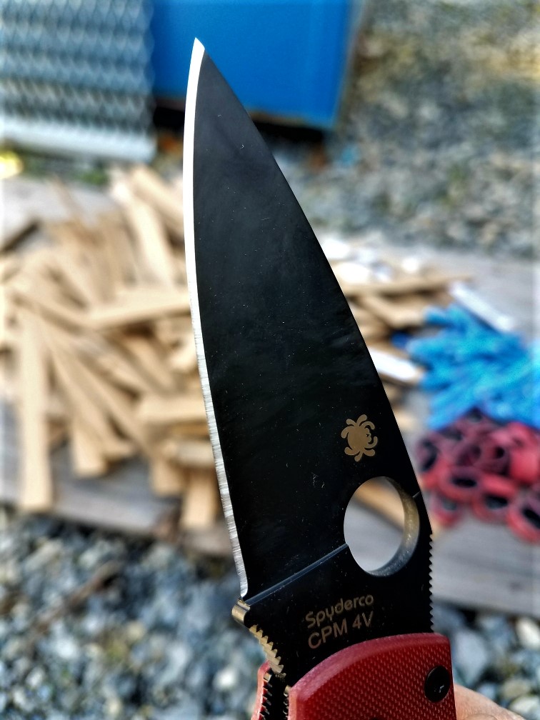

This week was the Manix 2 in 4V steel. I expected greatness, and it did not fail me! All week long, typical warehouse cutting was effortless. Still shaved and cleanly cut paper Monday-Friday with no touch ups. Today I decided to give it the typical, try and dull the blade a bit testing. I got a little more precise this week after reading Connors excellent review above.
I was in a bit of a time crunch, this knife could have EASILY cut more!! I ended up cutting the flaps off of a bunch of boxes into even slices. Ended up cutting approximately 240ft cardboard, the typical hydraulic hose that it went through like butter. The rope test I went for the same as last week with the 52100 Manix...that steel can't even hold a candle to this 4V! It was effortless with each and every cut. I stopped at 45 pieces, unlike 40 last week. The 4V never once slipped or hesitated cutting through any of the 45 pieces. When I finished up, I gave it a shot at cutting paper...of course, easy and clean cuts. I knew this would be the knife to put up against my current favorite and best performer the Rex45 Manix. In all honesty, I can't choose a true #1. They both performed equally for me the entire week each one was used and at the end of the week they were still razor sharp and effortlessly cut. A pretty noticeable difference for me between these 2 and any of the other steels I've used thus far.
I'm not sure of the chemistry between these two, anybody know or care to share which of these is supposed to have the tougher steel and higher wear resistance? Both knives edges showed no signs of wear after the week of use.
