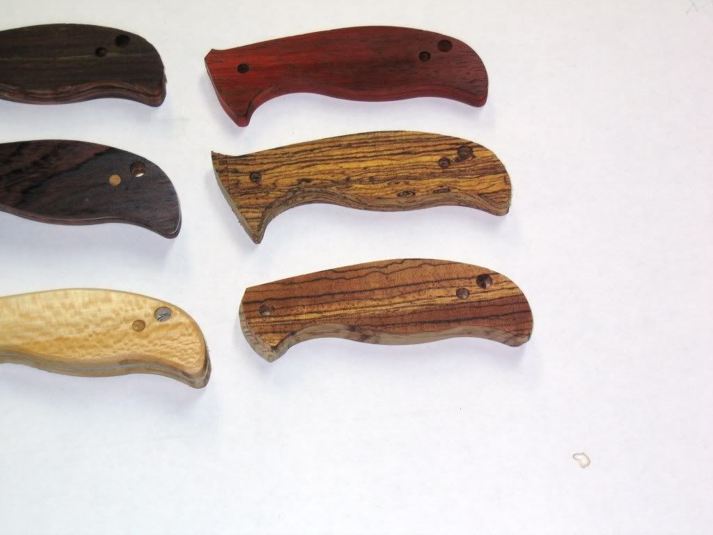

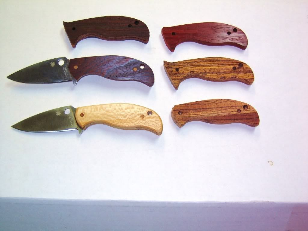

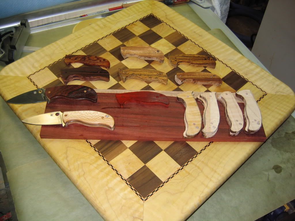

Some members on the forum approached me (PM) and wanted to know if I would make some basic scales for them. Here are some pictures of scales I have been working on. Several different types of wood. Several different stages of completion. On the piece of Paduak (redish orange board) in a clockwise order starting at bottom left. Quarter sawn Beech, Cocobolo, Paduak, 4 Curly Maple.
Above the board, starting bottom left going clockwise. Cocobolo, cocobolo, zebra wood, bocote, zebra, bocote

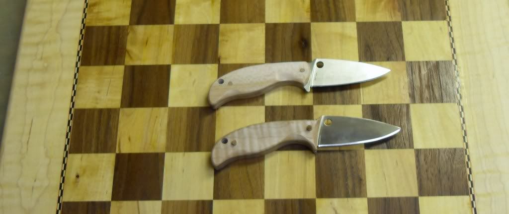

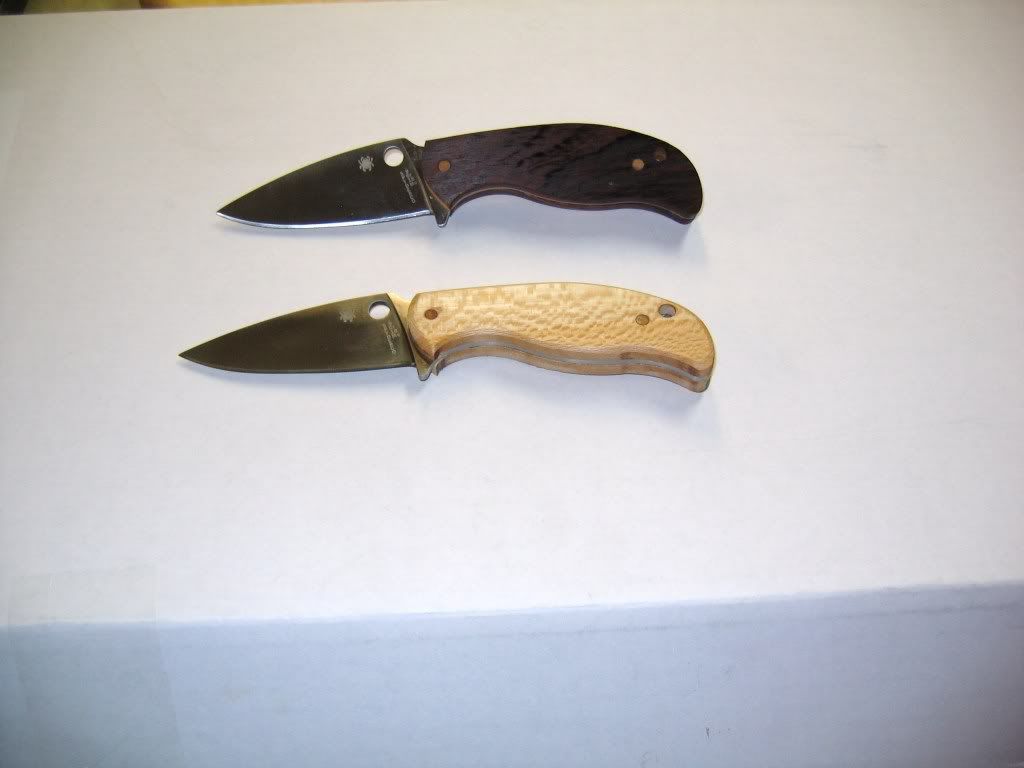

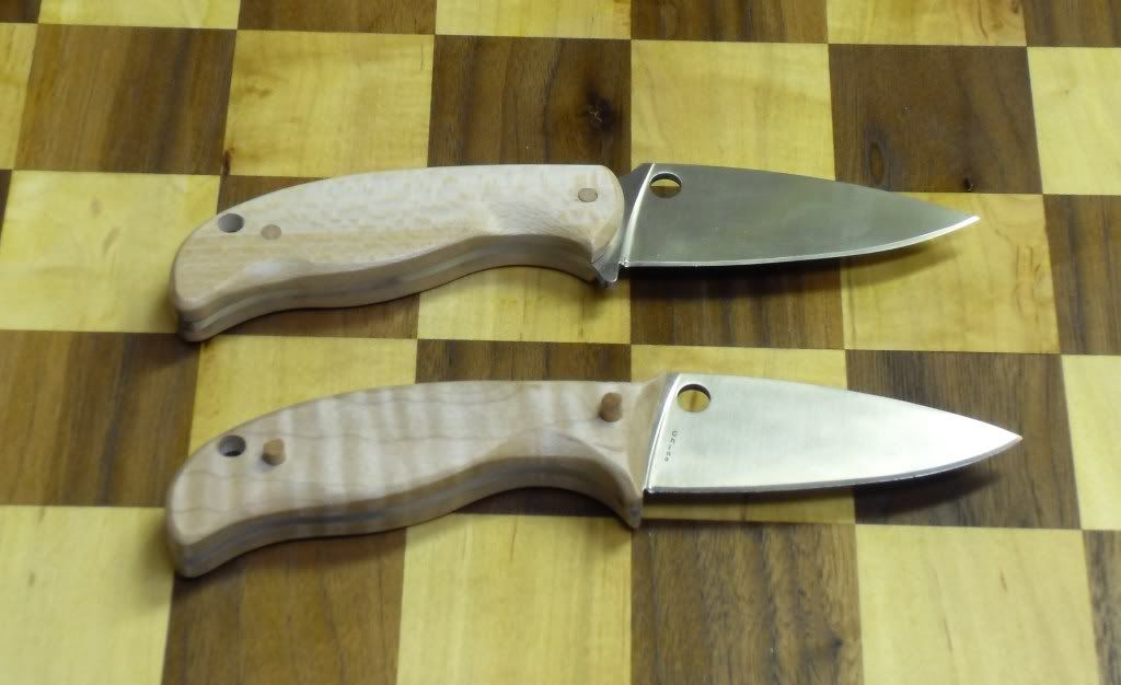

More pics. The chess board, really made the previous picture "Yellow"
vampyrewolf the Cocobolo ones are yours!
<a href="http://s250.photobucket.com/albums/gg27 ... les006.jpg" target="_blank"><img src="http://i250.photobucket.com/albums/gg27 ... les006.jpg" border="0" alt="Photobucket"></a>
<a href="http://s250.photobucket.com/albums/gg27 ... les007.jpg" target="_blank"><img src="http://i250.photobucket.com/albums/gg27 ... les007.jpg" border="0" alt="Photobucket"></a>
<a href="http://s250.photobucket.com/albums/gg27 ... les008.jpg" target="_blank"><img src="http://i250.photobucket.com/albums/gg27 ... les008.jpg" border="0" alt="Photobucket"></a>

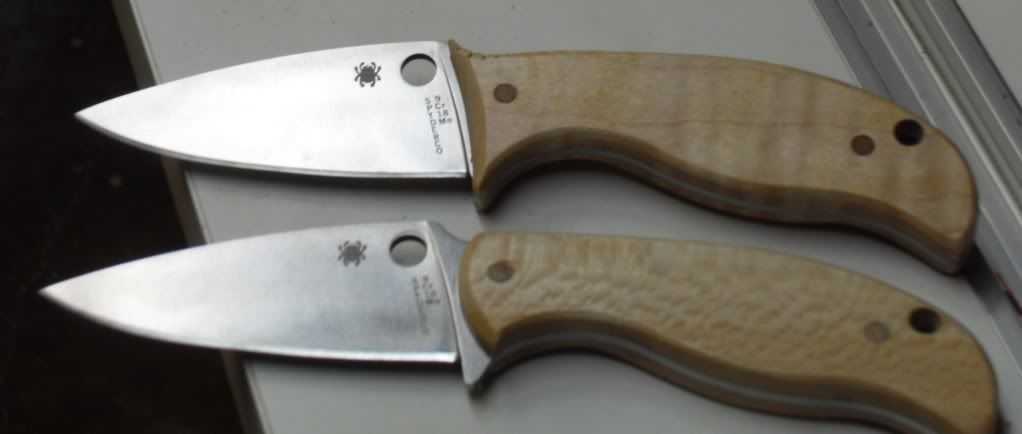

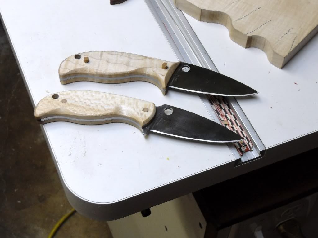

Some pics of two finished handles. They are not epoxied to the knife yet.
