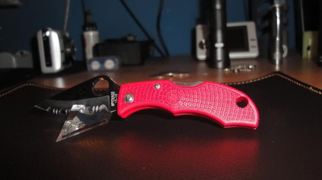

Scarlet..
Both..

sti wrote:scarlet..
both..
want!

The Scarlet turned out great!

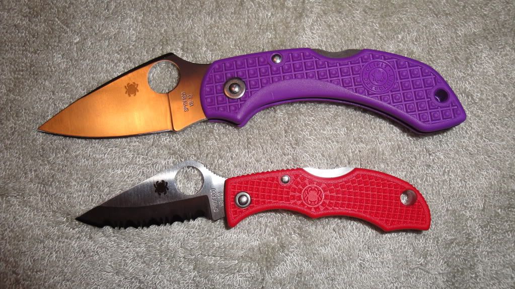

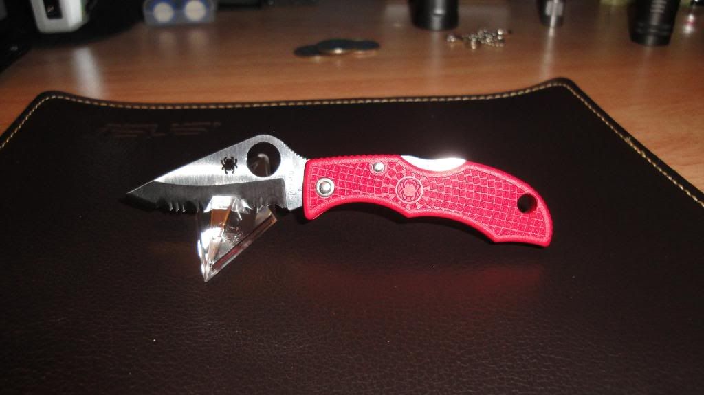

hiredgun wrote:Looking good guys. I'd like to see some clip side pics too if ya'll wouldn't mind. Question: If you were to have one of these clipped to your light colored pants and you got caught in a rain storm, would the dye transfer to your pants?
Here ya go..

That's just too cool! I REALLY like that Dragonfly. Well done! :) :) :)
