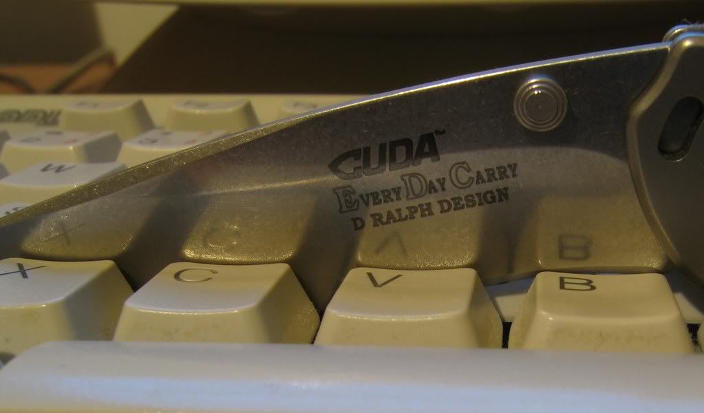

I performed little search concerning stonewash and found this term rather inconsistent.
E.g. benchmade states stonewashed and "tumbled" as separate types of satin finish.
Camillus describes EDC's type of finish as "satin" although it's obviously not typical satin finish one would expect.
Also it gets sometimes mistaken with beadblasted or sanded finish.
I'm not good photographer, however I tried to picture EDC's blade to show that it had to have been finished to relatively high degree BEFORE it was stonewashed (ref: "akin to primer on an auto"), it also has (not very clearly visible, only under specific angle and tilt) vertical grind lines similar to (not so high grit) satin:
(I had to use flash so please excuse crappy pics):
grind lines 1, grind lines2
it is quite reflective - that isn't something one would achieve by stonewashing raw steel, is it?
