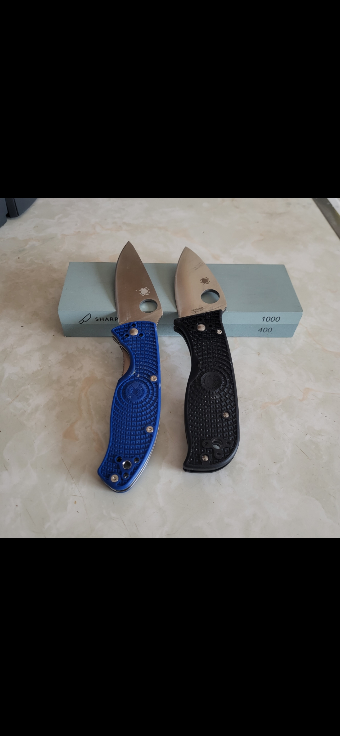

Sharpened up both these today on my sharp pebble 400/1k stone. The s35vn factory edge held up better than I predicted it would be. I have only used 8cr on the tenacious so this model and the upgrade in steel have been a refreshing endeavor to explore. The lil Temperance 3 lightweight in vg10 was also Sharpened on that same stone.
