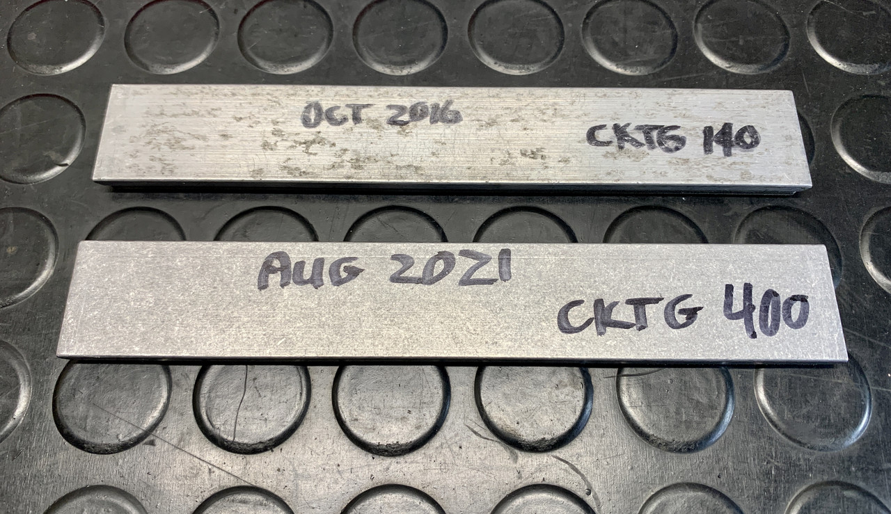

Testing out some sharpening guidelines for my upcoming edge retention tests. This maxamet was done to test the ceiling limits for the ceramic stone section that I plan on using in conjunction with other abrasives.

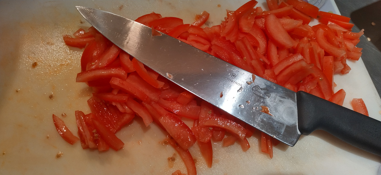

Someone told me my Sebenza wasn't as sharp as my Swiss Army knife the other day, so I figured it was time to hit the strop again. I took my time, and also hit my little LT Wright Frontier First that I carried through last week.

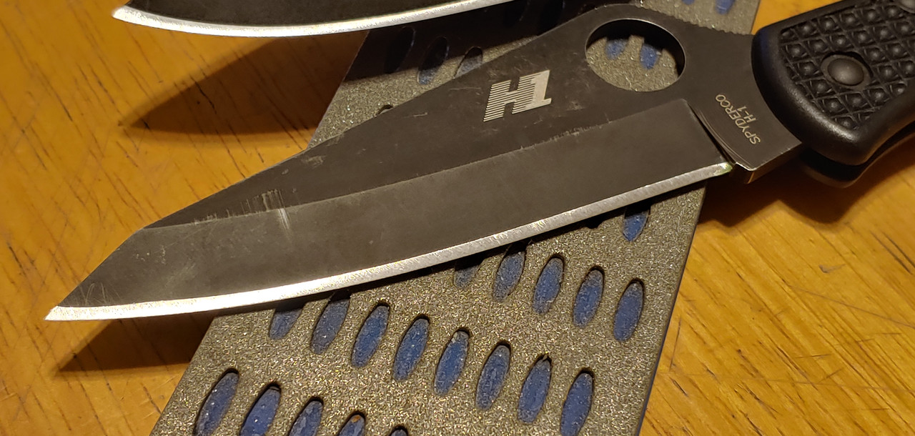

Touched up a couple of folders.
PE Pacific 1 - took the edge a tad bit thinner. Shaped the edge on 180 grit then polished up to 300 grit. Cleanly shaves and is very toothy - love the sharpening response from H1.
CE Resilience - Took the serrations up to a fine polish instead of just medium. Hair popping sharp now. Did a few strokes on the 300 grit stone with the PE part to bring it back up to 100% sharp after using this knife to break down a lot of cardboard and shipping tubes the past few days. Like H1, I love the sharpening response of 8Cr. Bit prone to burring heavily but with a light touch it gets screaming sharp.

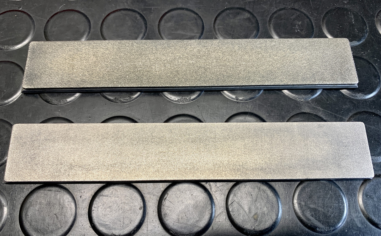

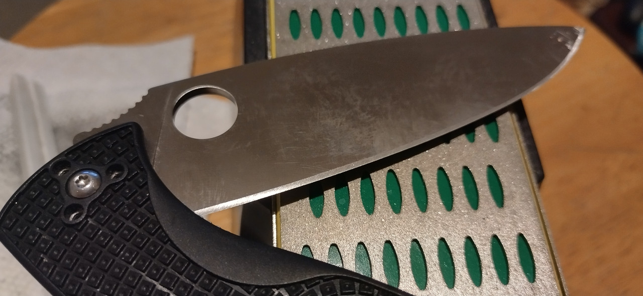

This is my oldest diamond stone, a ~20 year old DMT Fine.
Heavily worn down. Used to reprofile knives with it when it was my fastest cutting stone.
I still use it these days to touch up my polished edge work knife. Still gets edges screaming sharp.

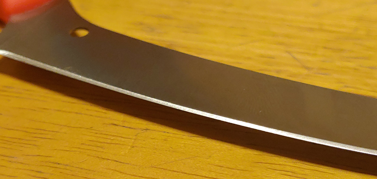

I spent a few minutes touching up the edge of my Polestar. I had used it cut some copper wire (wrong tool, I know) and it rolled some of the edge. After a *very* few minutes it was super sharp again. To be honest, I was shocked at how little time on the Sharpmaker it took to bring it back. Brown rods only, as vivi showed us.

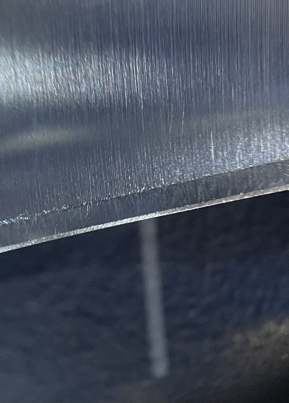

My new-to-me Microtech is taking much longer. Factory edge was not good and had some use/abuse. It's taking longer than I would like, but part of that is I thought it was CPM-154, but in actuality it is 204P steel. I guess I got a better deal than I thought!

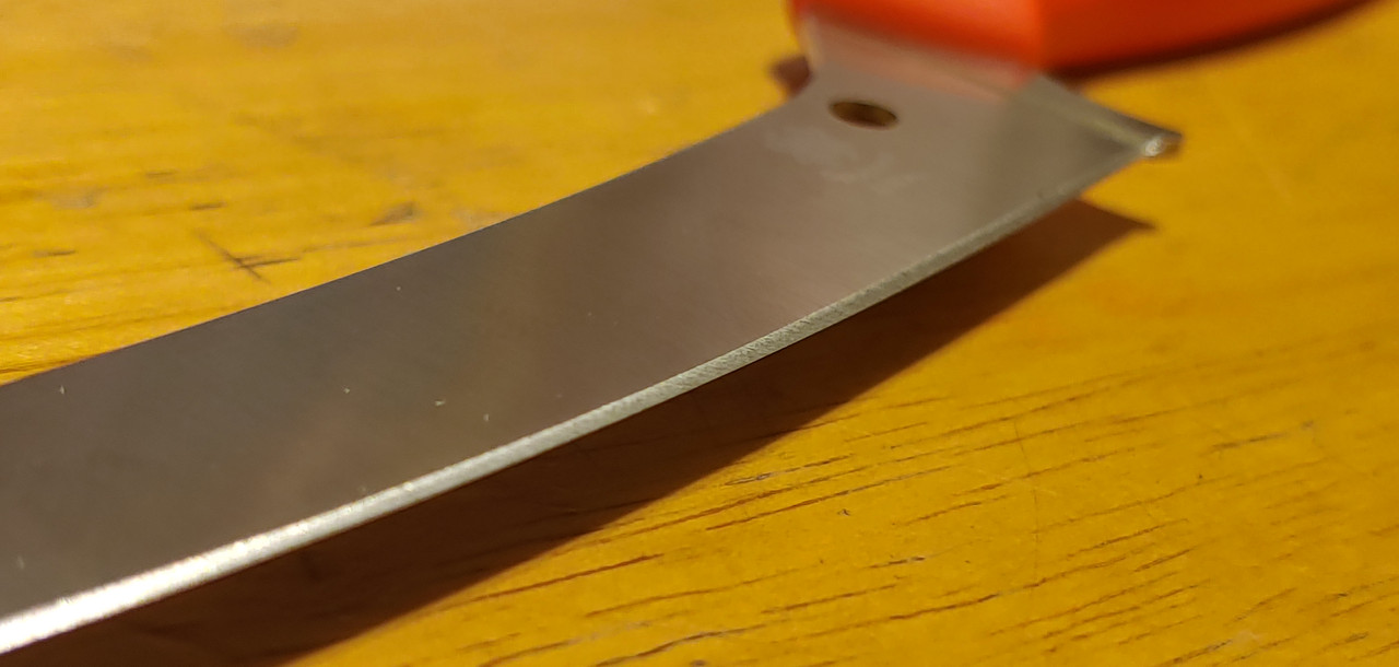

These photos are a testament to the excellent geometry on the Spyderco Resilience.
Took the edge thinner tonight, around 10dps. Doesn't look that much wider than the factory edge.
Polished the bevel up to 400 grit, then did exactly one stroke per side on the fine rods free hand. Sends arm hairs flying but has teeth for days. 8Cr as HT'd by Spyderco is a pleasure to sharpen.
