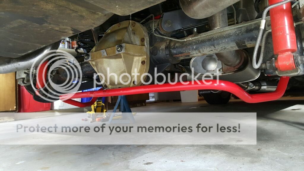

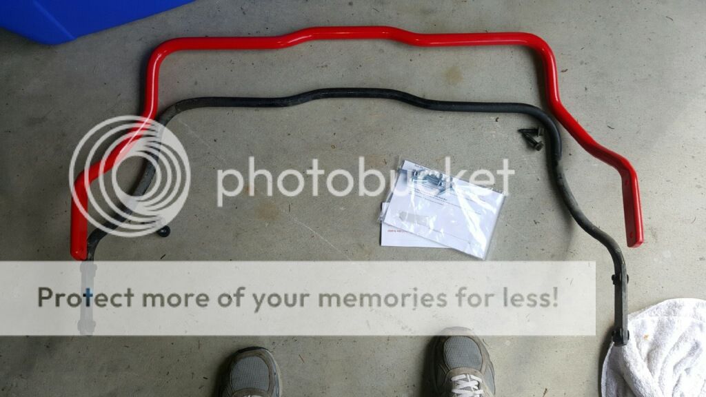

Another update:

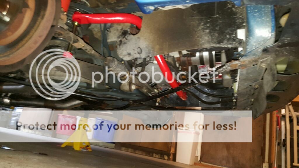

So the suspension was tired. In the words of my friend, "Every piece of rubber looks like a 30 year old tire." We ordered a bunch of parts from Summit Racing. Free shipping on orders over $150 (I recall) is great because everything weighs a friggin ton on this car. :p
The Ford Racing front a-arms couldn't be installed. We are going to drop it off at a suspension shop as we already were planning an alignment there.
Eibach front and rear swaybar kit is installed with new poly bushings and endlinks.

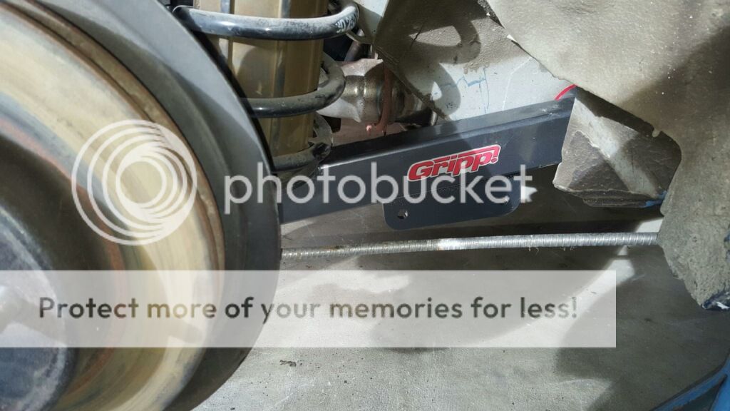

BBK rear control arms (upper and lower) with poly bushings are installed too.

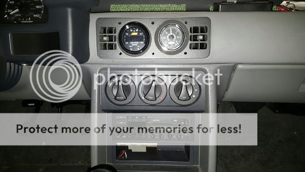

It had a single A-Pillar pod with a boost gauge. We removed it and found a cleaner solution :). Salvaged the boost gauge and added an AEM UEGO wideband O2 (A/F) Gauge and sensor.
Tuning is a different matter. The factory EEC-IV system with MAF does a pretty good job of figuring out fuel. This time around we didn't want to go with "good enough" so picked up a Moates Racing Quarterhorse and supporting software to tune the ECU. This weekend we are going to do a few third-gear pulls and figure it out. It's pretty lean off idle and then seems pig rich at WOT; timing is being pulled at the distributor and with the MSD boost control knob. Tweaking the fuel curve and adding timing should make it more economical AND punchy. As for if it's going to put down more than 320whp (ish)? Not really sure. 6psi of non-intercooled boost on a bolt-on Windsor isn't anything to brag about but we already had one fast Mustang that drove like crap. It will be interesting to see what the 21st century has to offer. If it's anywhere in the 12's and runs nice that is scary enough for us :D.
