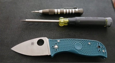

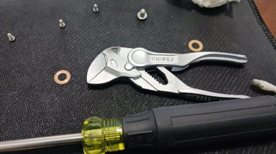

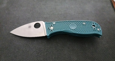

#131
Post by zuludelta »
I got accidentalky doused in some corrosive liquid at work the other day (nothing toxic, thankfully, but the pH was somewhere between 3.4 and 2.5) and some of it got on my LT3LW in K390, which I was using it at the time. I rinsed the knife under running water at work, but decided to do a full teardown of the LT3LW when I got home, just to make sure I was able to get out all the corrosive residue and to check on the blade tang/pivot area (K390 is a non-stainless steel, though it offers some resistance to corrosion).
Thought I'd share my experience in this thread, for folks who've never taken apart the LT3LW before (I've also posted about my experience taking apart the original G10 LT3 in an older thread).
Disassembling the LT3LW is pretty straightforward, requiring only a T6 screwdriver for the body screws and clip screws, and a T8 for the pivot screw. There is a small steel washer/collar underneath the pivot screw, so be mindful that you don't lose it. Also, taking off the clip is only required if you want to separate the clip side liner from the FRN scale (I wanted to check the hidden side of the liner for corrosion). If you don't need to do this, you can leave the clip on.
I found a Knipex XS Pliers Wrench useful in teasing apart barrel spacers from screws and manipulating the pivot & the phosphor bronze washers. It was small enough to get a purchase in tight spaces while providing a lot of grip, and the smooth jaws did not mar surfaces.
One hiccup I encountered was the anvil pin/stop pin. It seemed to be stuck, either because the retaining screw was stripped or due to an overzealous application of thread locker at the factory. Either way, I didn't want to push my luck, and found that I could get enough separation between the show side liner & scale to clean their mating surfaces even with the anvil pin only partially unscrewed, so it was a non-issue in the end.
After cleaning & wiping down all the internal metal surfaces & applying lubrication where it was needed, I reassembled the LT3LW & the process was just as straightforward as taking it apart. (Just be mindful of the D-shaped holes for the body screws & pivot)
One thing to keep in mind, the LT3LW doesn't use the pivot bushing system used in newer production Compression Lock folders like the Para 3 LW, the CQI Kapara, and more recent production batches of the PM2. What this means is it will take some trial-and-error and dialing down of the pivot tightness for the action to get to the point that one prefers. Also worth noting: the blade was centered pretty much as soon as I put it together, and didn't need any additional fiddling. I noticed a minor amount of lockstick that wasn't there before, but after flicking the knife open & closed about a half-dozen times, that went away.
All in all, a pretty painless process, though it's not something I plan on doing regularly, and I'll probably do this again only if I get the knife doused in a corrosive liquid (which is hopefully never). In my experience, compressed air and pipe cleaners are enough to keep a folder's internals clean, unless one is working in exceptionally grubby conditions.
