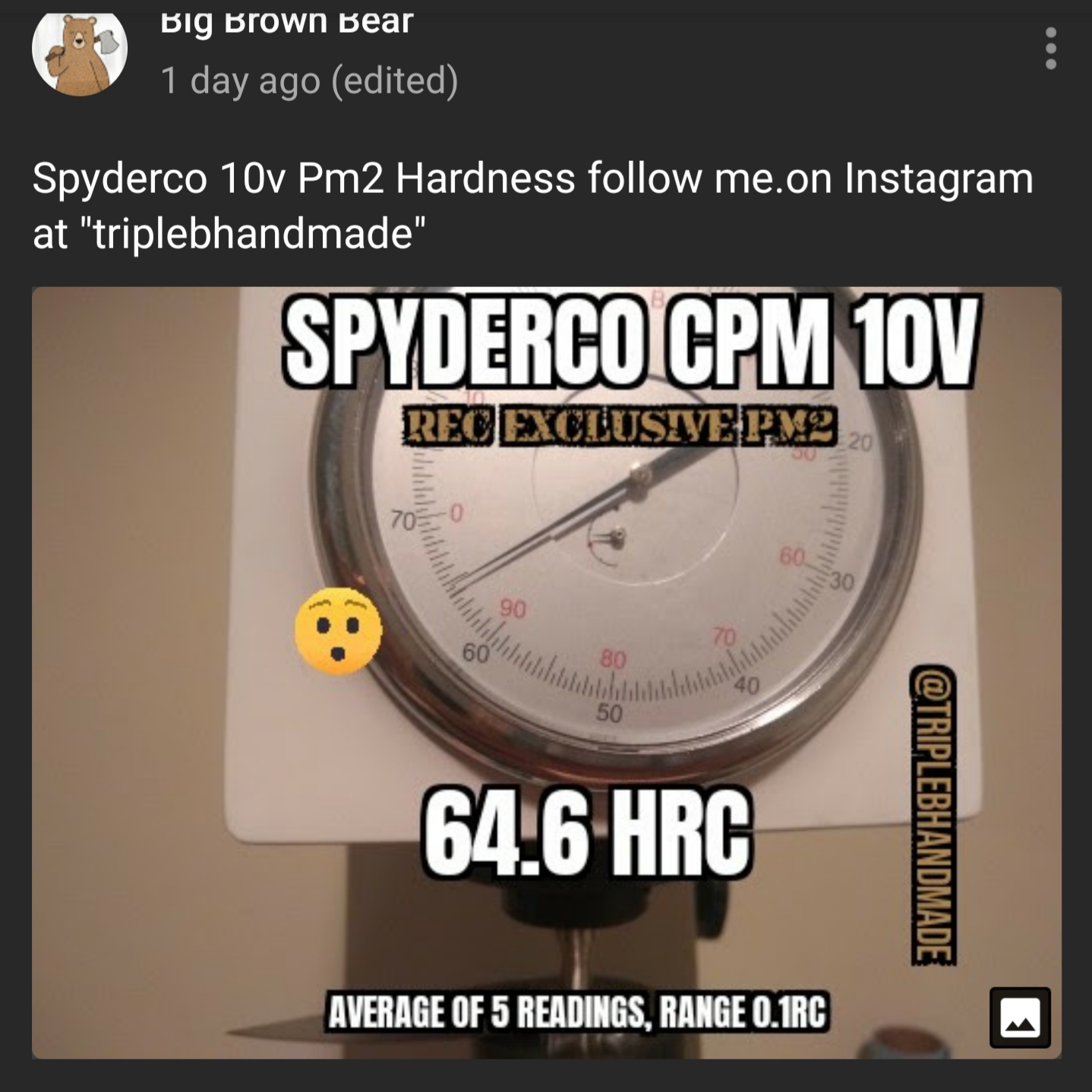

emanuel wrote:
Sun Mar 22, 2020 2:27 am
Someone with the new PM2 in 10v, if they have the means, can they post some hardness measurements? Thanks!
Anyone test this one yet?

Post by Albatross »
abbazaba wrote:
Sun Mar 29, 2020 8:52 am

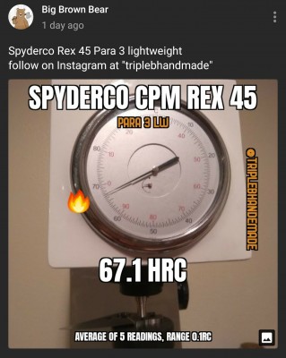

Post by Albatross »
And another from BBB...

Re: HRC Database
#125
Post by The Meat man »
Awesome! Thanks BBB and Albatross for sharing!
Good to see a higher number for the CPM 10V.
And that REX 45 - incredible! :eek:
- Connor

Location: Romania
Re: HRC Database
#126
Post by emanuel »
The Meat man wrote:
Sun Mar 29, 2020 9:07 am
Indeed, for people that don't like high carbide steels, Rex 45 is the peak their should strive for. Amazing steel in a high polish edge.

#129
Post by EngDevGr3 »
I had a few tested. The 10v satin PM2 was 64.5. The manix 2 rex 45 was 66.7.
