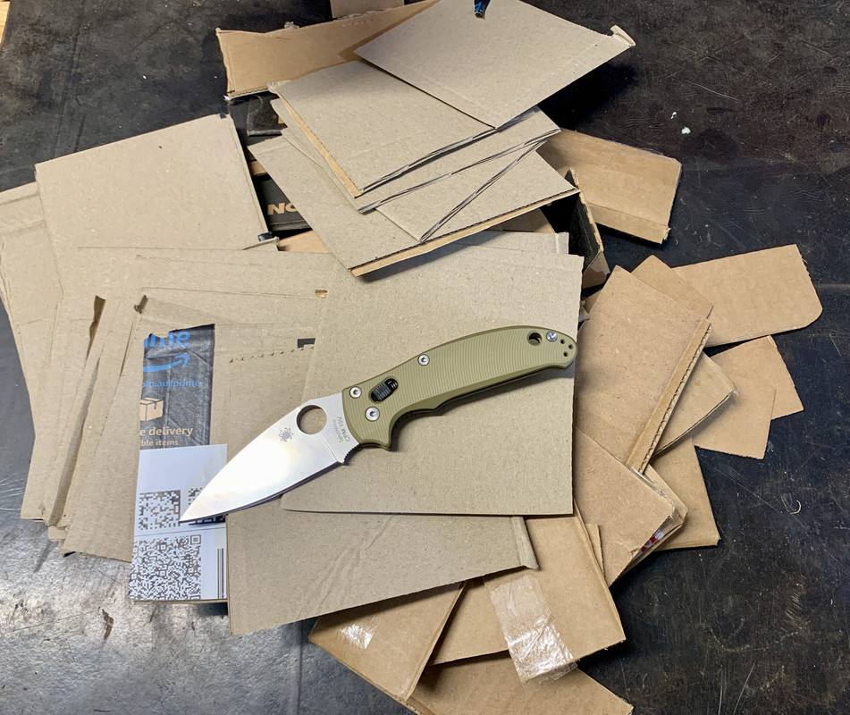

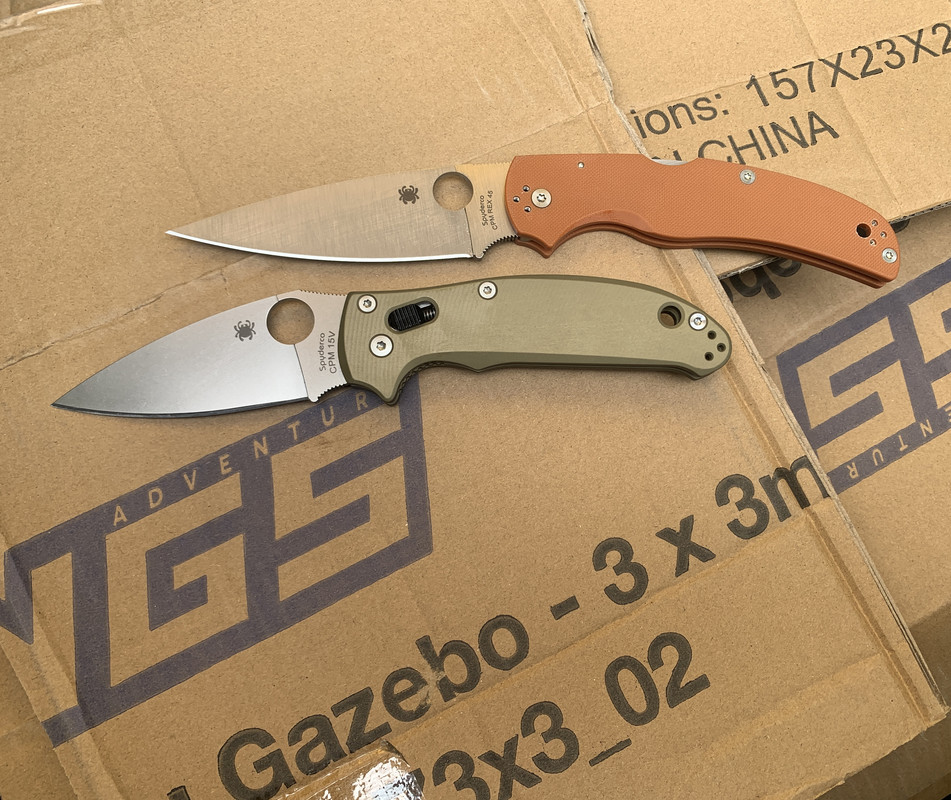

@ejames13
Quick test to demonstrate how quickly I lose shaving sharpness. Perhaps other people see better results? If so I'd like to know their secret!
Two sharp knives, both shaving arms hair with and against the growth:
Native Chief REX45 (safe queen)
- new factory edge with what appears to be a DMT fine or SM ceramic (?) micro bevel @20 dps
- maybe stropped once I cannot remember
- cut up a sheet 1m x 2m of dirty double wall corrugated cardboard (dusty from lying flat on my concrete garage floor)
- not shaving arms hair afterwards
Manix 15V
- Fresh 2nd edge after factory edge, 1000 grit diamonds @16dps
- 1 micron diamond strop
- cut up a large dirty double-walled corrugated cardboard box, which contained a 3x3m foldable gazebo.
Stropped both:
- 1 micron diamonds on basswood, only 3 passes per side
- clean kangaroo leather, only 2 passes per side
Both shave arm hair again, with and against the growth. Not quite hair "popping" like a fresh edge, but clean shaving. They can both slice fine sigarette paper, not quite as cleanly as a fresh edge, but 90% there.
Shaving sharpness on cardboard is fleeting in my experience, longer lasting if you only cut soft media like food.
Posing for a picture after cleanup...
If I define "sharp" as hair popping, and "dull" as not cleanly slicing cardboard", I'd say the shaving sharpness lasts perhaps less than 3% of the life of the edge (my own bold subjective estimate). I lose shaving sharpness after 1 box, but could break down another 30+ before I'd want to resharpen, with K390.
We pay the big bucks for these steels because, unlike their low carbide brothers, they keep this "low-sharpness" plateau for a long time. And a few other reasons of course.

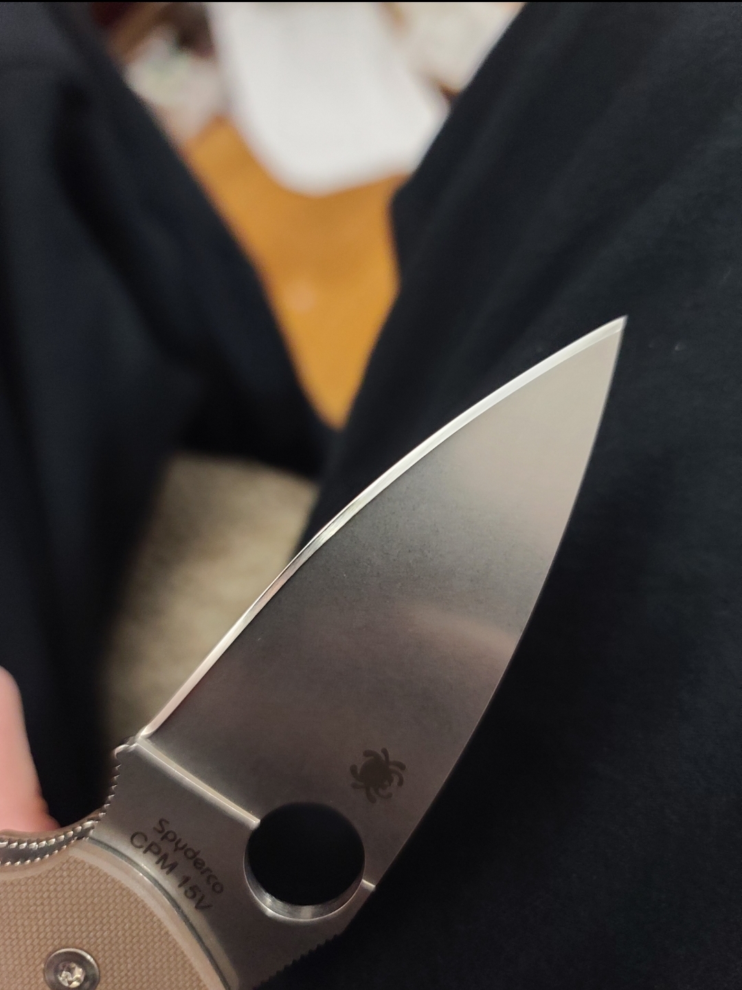

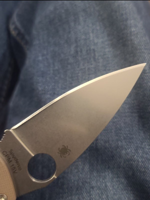

@Deadboxhero
Just finished giving the 15V Manix a new edge. It by no means needed it, I just wanted to get a feel for Spydercos, and you're, special heat treatment on the blade. How'd I do? (Be honest lol I've been sharpening quite a while but I'm not as good as you or others).
I used my WorkSharp Professional Precision Adjust, went up to 800 grit on the diamond plates because that's all I currently have in diamond/CBN (saving for an EdgePro and bonded stones, expensive but will be worth it, as my freehanding isn't what it used to be).
Took it to 15° per side, followed by stropping with 1 micron diamond emulsion. Was very easy to sharpen, was very easy to deburr. That's what I love about this steel. Cuts like a lightsaber, sharpens and strops in 20 minutes.
Thank you again for making this possible. This is exactly what my wife would've loved.
Jacob
Edit: Second picture added(shown as first picture) after a few more minutes on the strop on various grits of diamond compound, then back to the 1 micron diamond emulsion. It's now slicing free hanging paper towels.
