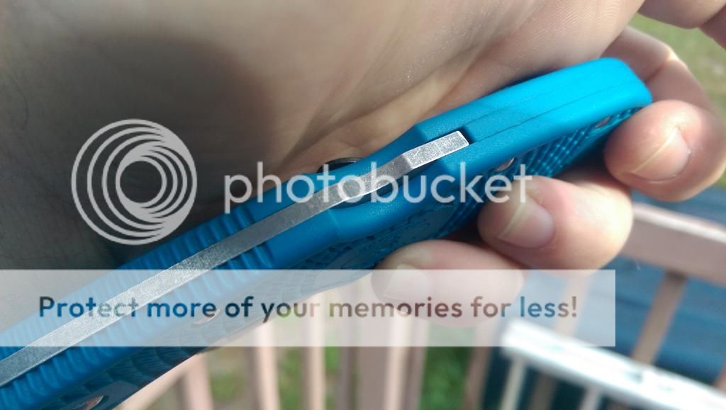

got bored with my endura so i decided to change it up some. acid etched the blade and lockbar and also stonewashed them. think it came out pretty good.

Tracy, nice job blue Endura's one of my favorites. What did you protect the edge with?

thanks jazz.. i used nail polish on the edge and pivot. the acid doesnt eat through it so it keeps it nice.
