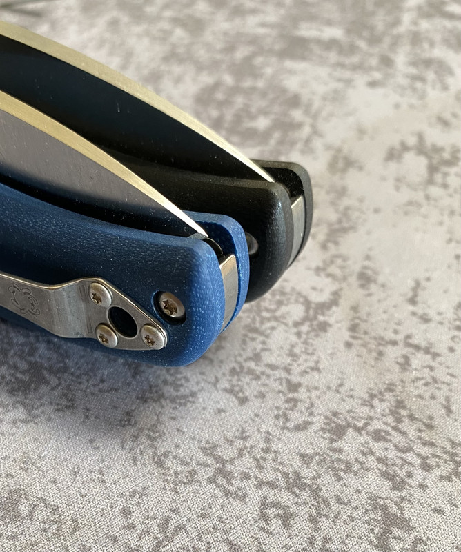

Purchased a new Shaman in SPY27 from an authorized dealer last week. Knife was 100% new and unused upon opening.
I noticed pretty quickly that the tip is almost exposed when the blade is closed. So much so that I was able to catch (and cut) the tip of my finger by pressing down with moderate force and running it from the bottom of the scales onto the spine. For comparison, note how much lower the tip is on S30V model pictured. The SPY27 model looks like you might expect after several reprofiles or heavy sharpenings, but I'm pretty sure these are robot sharpened at the factory.
So why such a difference between these two? I found several other examples on the interwebs of the same issue, which seems to be specific to the SPY27 variant. Honestly a little surprised these are making it out the door like this. I sent a pic to the dealer, and they told me to send it back immediately because it doesn't look safe. It certainly wouldn't be after a few full sharpenings.
SPY27:
S30V:

Hi Ejames,
Not right. Can you send it to Spyderco? I'll alert Customer service.
Posts: 28338
Re: Shaman SPY27 nearly protruding tip
Yeah I'd send that in. This is a detail I've been extra aware of ever since noticing it on my Caly 3 years ago. There are ways you could fix it but like Sal said that doesn't seem right compared to others I've seen (and own).

I have to say, my Knifecenter Exclusive Shaman S90V and Bodacious look exactly like that. I assumed that was the way the blades are supposed to sit in the handle now. (My old S30V Shaman from back when it was first released has the tip much more "sheathed" by the handle when closed. )

Is this a question of the blade being shallower in the handle or maybe the edge is ground too far back raising the tip?

Just by looking at the pic, the bte thickness on the spy27 looks thick. To me that would say the blade was ground more than normal. Maybe they messed up the first edge and reground it to try and fix it

If this is the case then you'd also see a slight reduction in blade length too.

It is quite a common problem with the Shaman. I have also experienced it once with an early production S30V model. I owned 4 Shamans and they all had their flaws (tip reaching out with 1 model and all of them had a burr on the D shaped hole in the liner, causing blade play). After removing the burr you can eliminate horizontal play.
All models (mine) have a tiny bit vertical play/rock which you can not eliminate. For use it is not a problem.
