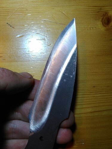

As a clear example of the effectiveness of silicon carbide stones. This is a blade made of steel s60v with a hardness of 61HRc
I argue (within a reasonable time) that such work cannot be done on a diamond, you simply cannot create such pressure on the blade that the diamond would begin to cut steel (the contact area is large, the pressure is scarce). The blade will simply slide over the stone.
And even if you can push that hard, you won't be able to maintain that pressure for long.
But the soft water stone Suehiro GC-10 220 grit copes with this by updating a new and very sharp abrasive.
