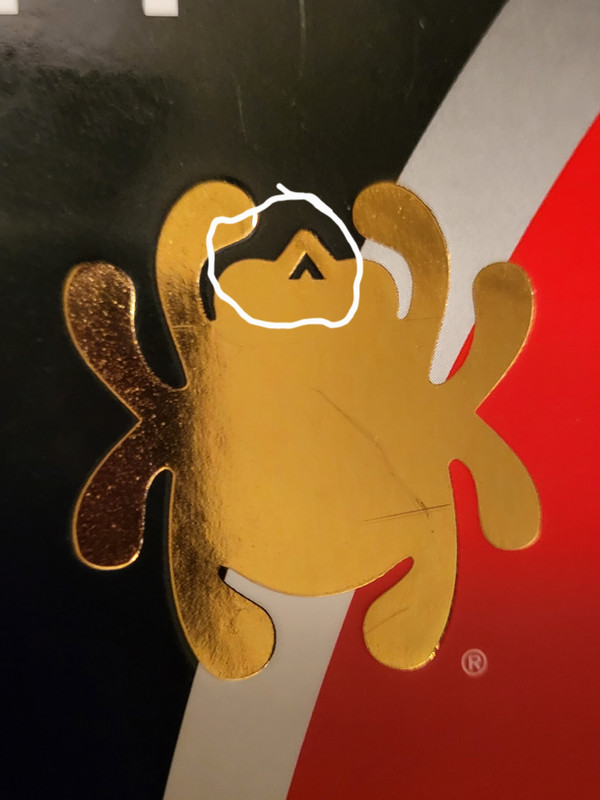

Does the size of the triangular opening on the fangs of the spider logo indicate a fake? I saw some posts and a YouTube video about spotting fake spydercos claiming this. When I checked out my spyderco boxes I noticed 2 of the ones I have look like the "fake" box.

My manix 2 box with the smaller triangular opening which is supposed to be the legit logo
Notice how the triangles on the first 2 boxes are bigger and the opening is much smaller on the manix 2 box. Supposedly boxes with the bigger triangular opening could be fake. Is there any truth to this?

I happen to have 14 Spyder boxes in my garage right now, all bought from legit places (like DLT, GPKnives, or BHQ) I'll go check each of them and see if I can confirm for you, Eagle eye.

Alright, just checked. Every single box I own has a triangle like your St. Nick's and BHQ boxes. I don't have a single box like your Manix box.
While I can't confirm that this means fake or not, I can definitely confirm that it's not "normal". Can you post a picture of the item label on the end of the box, and if the manix itself from multiple angles?
I'll post a standard, stock Manix 2 panel for you to compare to.
