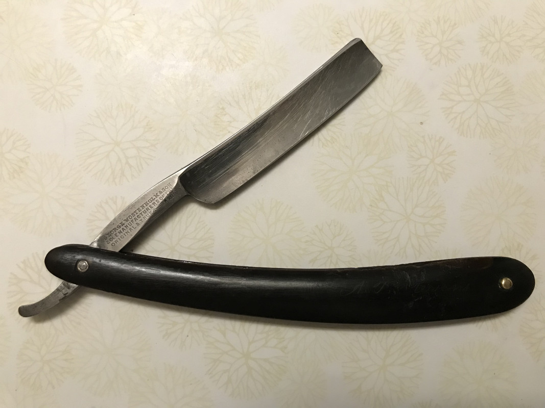

It's a mixed bag.
For instance, the IXL (top left) has a cracked blade, which the seller didn't mention. Fortunately the crack is less than 1/2" from the tip. I'll cut that off and should have a very good 2-3/8" blade.
The blade looks to have never been honed, very clean, minimal staining.
Points off for the plastic handle.

That's too bad about the IXL. That looked to be one of the better ones. I can't read the names on the others, but the IXL didn't look to be used much. If you are careful about the heat you can certainly shorten it, if it would be worth it. The rest look like they'll clean up nicely and make good users.
I had thought that if I ever bought a bunch together like that I could PIF one, along with a brush, soap, and strop to someone who would like to learn to shave with a straight razor, but can't afford to buy a good one.
Re: Anyone use a Straight razor/Artist Club razor/Shavette razor?
I chopped and honed the IXL. It shaves well, I'm satisfied. I might try making a handle for it.

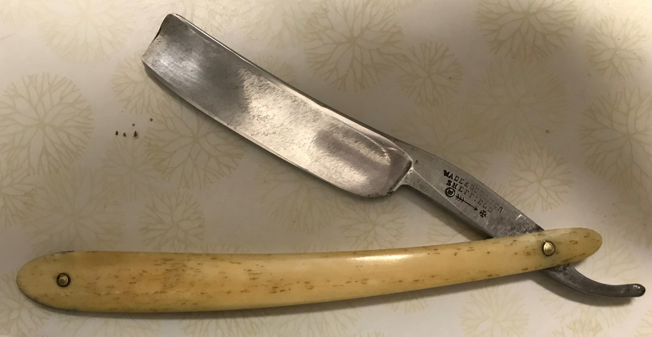

The wade & butcher sharpened up like a dream despite being all uneven due to what looks like, someone with a sloppy dremel trying to clean it up.
First shave was very good, very close, very smooth, almost zero chance of blood, as well as my boker. It doesn't give any audible feedback while shaving, which is new to me, but I'll get used to it.
It has a big thick heavy blade and bone handle. The handle stays firmly wherever I put it, yes!
No idea when it was made, but I suspect pre 1900.
As beat up as it looks, if it maintains well, it will join the boker as a regular. Time will tell.

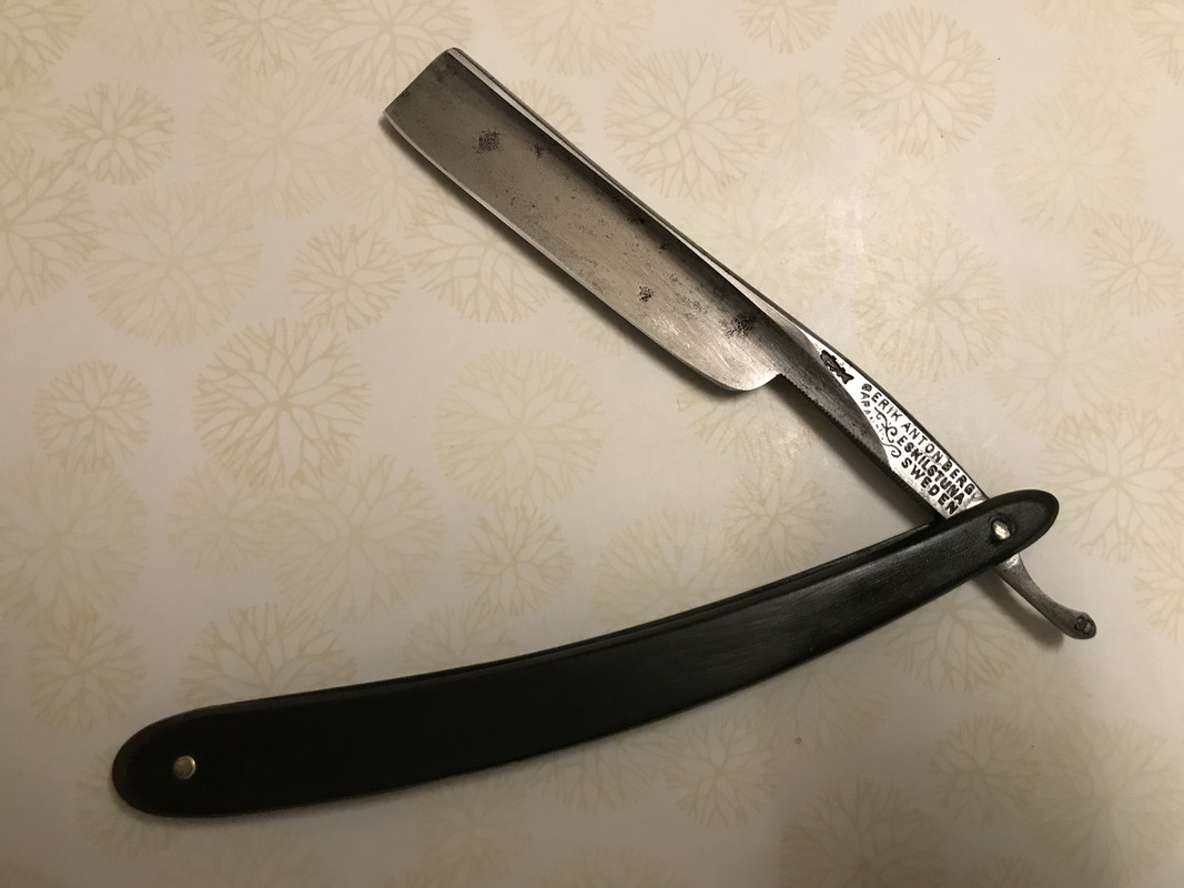

Erik Antonberg Swede razor.
I was looking forward to this being a better one of the bunch, but so far just the opposite.
I knew something was wrong when I heard popping and felt grittiness on every few strokes.
The edge is crumbling on any/every stone I use, resulting in microchips along the edge.
Goes to show you never know what you have till it's put to the rock.
If I can't get it sorted out, the horn scales will replace the plastic on one of my others.
