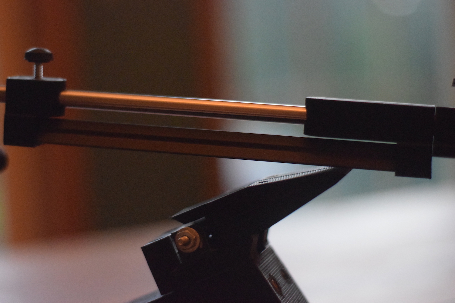

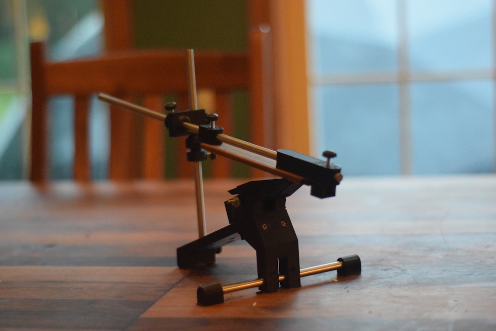

Hello everyone! I thought Id show you my 3d printed sharpening system. Its basically an edge pro system but better! First of all an edge pro Apex 4 system costs 255 dollars and while this one, depending on what materials you use, can cost you under 50. Secondly it is very customizable; the designer is constantly adding more files and attachments. One of my favorites being an attachment for the Spyderco Sharp-Maker stones. There is also a scissor attachment, a convex edge attachment, a chisel attachment and much more. The design is very well thought out. It is also universally compatible. Meaning any name brand stones you buy should fit it. Honestly I think this is the best option if you don't feel like spending lots of money. It cost me around 70 bucks total for mine and I bought nice electroplated mono-crystalline diamond stones! You could even buy a 100 dollar set of edge pro stones and the price would still be at least 100 dollars shy of the price of an Apex 4! This is one of the many reasons why everyone needs a 3d printer! They save you so much money in the long run! I had a hard time finding hardware so I've listed where you can get them bellow. Although i found assembly to be very easy, I can help anyone you needs it.
Here are the files: https://www.thingiverse.com/thing:4135236
Consider giving the designer a tip if you can.
The materials you will need:
The M4 brass inserts: https://amzn.to/2TJoxzj[
The M4 x 12mm thumb screws: https://amzn.to/3AFvD8w
The 8mmx 400mm steel rods: https://amzn.to/3dT6MEm (Note: this is a set of 2. You may want to cut 180mm off of your vertical rod to use as a base, although you can print a base if you prefer.)
M4 20mm hex screws: https://amzn.to/3jUkElB
12 x 3mm magnets: https://amzn.to/3yMpJB1 (Note: you won't need these if you plan on using the clamp exclusively.)
You will also need a machine screw around 2 inches for the clamp holder and a wing nut that fits it.
Stones:
Highly recommended if you have the cash: https://amzn.to/3wmR2jx
Decent cheap stones: https://amzn.to/2VdAPAh (NOTE: These will last if you use soap and water.)
The stones I'm using:
https://www.amazon.com/gp/product/B08JP ... UTF8&psc=1 (Currently Unavailable)

To in insert the brass inserts simply attach one to a screw, heat it up with a lighter for 20-30 seconds, and press it down into the hole with steady pressure while remaining perpendicular to the surface and in line with the hole.

You may also want a spring for your horizontal bar. The inner diameter must be at least 8mm or it will not fit. So if your wire is .8mm you'll need about a 10mm outer diameter to fit. It should also be a compression spring and not an extension spring.

Heres what the designer had to say:
One of the posts (your post) mentions a serrated blade and a Spyderco triangle rod; if it's a long serrated blade then the best way is to use the magnets on my system (not a clamp), and move your knife every few serrations to stay centered and not round the sides of the serrations.
"Some call me...Tim?"

This sharpener is easier to make than you might think. There are directions in the thingy verse file. I didnt have to reprint any parts.
I use a Anycubic Mega Zero 2.0 with a Creality glass plate. I use glue sticks for better adhesion and i use Cura slicing software.

If you do make one id recommend using the magnets and not the clap.
