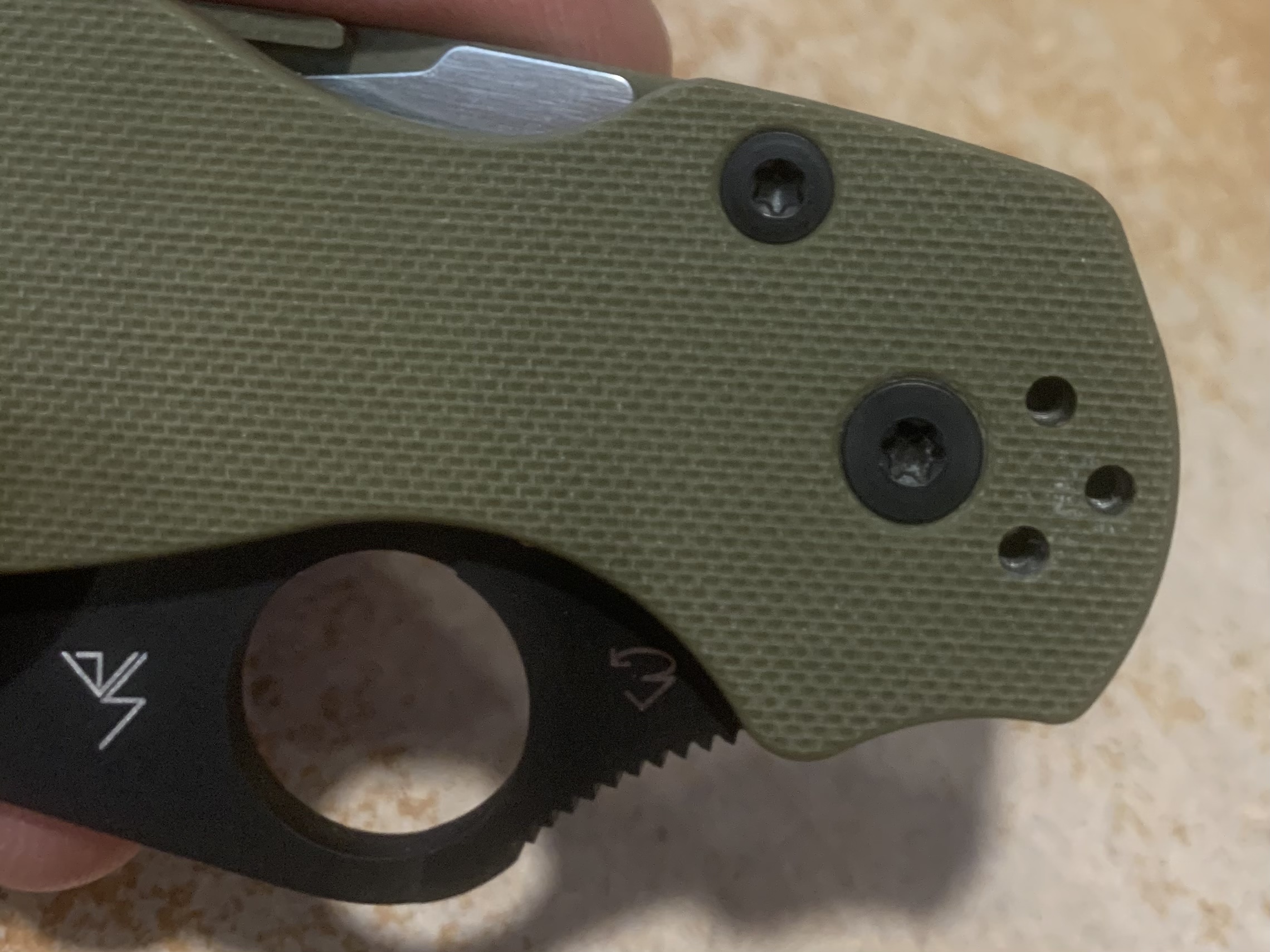

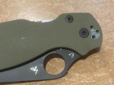

Remove Loctite from G10
Post by not_the_sharpest »
So I was flipping my new PM2 clip from tip down to tip up. After stripping the torx heads on two of the screws I finally got the clip removed. Underneath the clip I discover there was loctite on the scales. What is the best way to get this out? I tried a little alcohol but that didn’t seem to do much. I tried a magic eraser and applying heat but am afraid to get much more aggressive since this was the olive drab G10 from the latest DLT exclusive.

Thanks for the replies. I've tried acetone, mineral spirits, WD40, Goo Gone followed by some scrubbing with a plastic bristled brush. I may have made a little progress, but I have not found a miracle remover. I received replacement screws from Spyderco and they came with some 243 thread locker, so I'm going to try a little of that when I have time.

So I tried using a little Loctite that came with the replacement screws to remove the dried on stuff. I dampened the are with Loctite on a q-tip, let it set for 30 seconds of so the scrubbed with a brush. Then cleaned the area with mineral spirits/acetone. In addition I used an Xacto blade to poke down in the grooves to break up some of the larger chunks. After repeating this cycle 8-9 times this is the end result. Not a silver bullet but it is better.
I wouldn’t mind if they shipped clips loose, but I can certainly see why they don’t. Eliminate the Loctite for the clip and I’d be satisfied.
I did reach out to CS to see I go they had any tips, and have not heard back yet. I also reached out to Henkel to see what they recommended.
