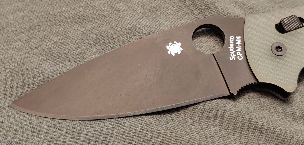

The premise of this thread is simple.
I will be posting photos of my M4 DLC Manix XL and we will watch for signs of corrosion.
Here are photos from my first week of carry:
I will be treating this knife like any other non-salt knife in my collection. I will carry it and use it on anything I'd use a folding knife for, including acidic foods. I will not be oiling the blade, because in my experience it wipes off as soon as you slice through a box or two.
I won't be soaking it in salt water overnight trying to rust it, but I won't be babying it either.
In regards to corrosion, so far the Manix has cut some food, and has been carried IWB on a few hikes where it was exposed to sweat for a few hours. There is zero corrosion visible on the knife after week 1.

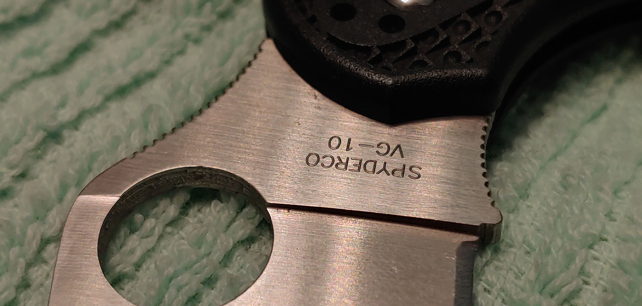

For comparison, I rusted my VG10 Police 4 Lightweight carrying it IWB on a bike ride for a couple of hours. Uncoated M4 would definitely be showing corrosion for me by now, no question about it.
Here is a photo of the Police after that bike ride. Zooming in reveals light specks of rust across the blade:
Here is some rust left near the pivot after wiping most the specks off with an oiled rag:

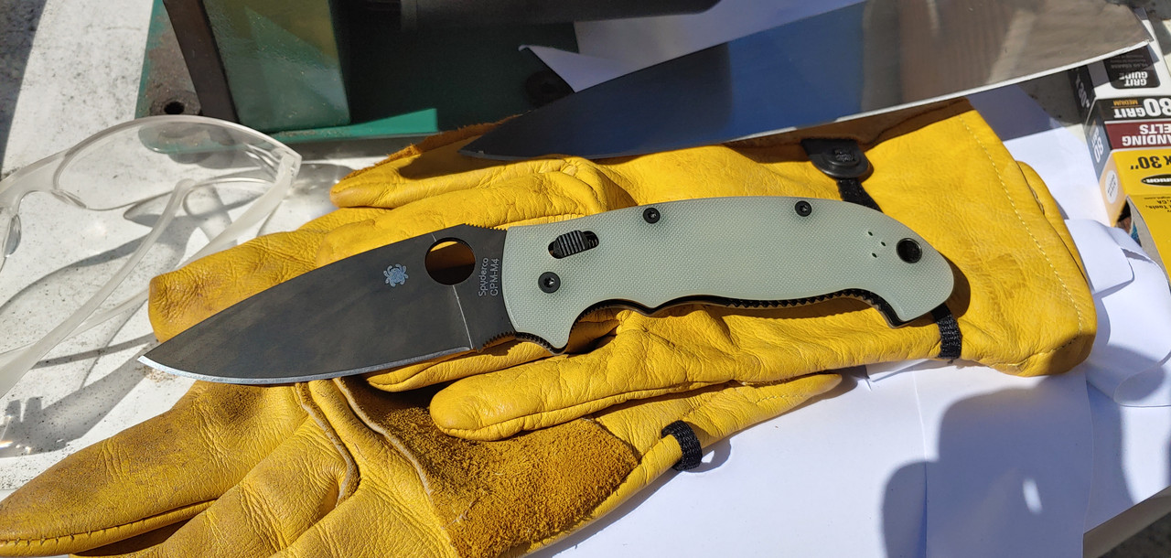

The model I selected was a DLC Manix XL. You can see me beating mine around in the following video:
https://youtu.be/hl3n-BtLoaI
Now this knife I treated just like a Salt. I carried it everywhere year round and used it for anything I'd use a folding knife for.
Similar to my experiences with the Para 2, the blade remained pristine. But so did the rest of the knife.
This was absolutely unheard of for me outside of the Salt line.
I rust anything that goes in my pockets. Apparently I sweat battery acid. I rust my pocket Leathermans. I rust my split rings on my keys. I rust belt buckles and rivets on jeans. I have rusted every non-salt pocket knife I've carried during physical activities besides that Manix XL.
Seriously. Not a single speck of rust, at all. Anywhere. My mind was blown.
