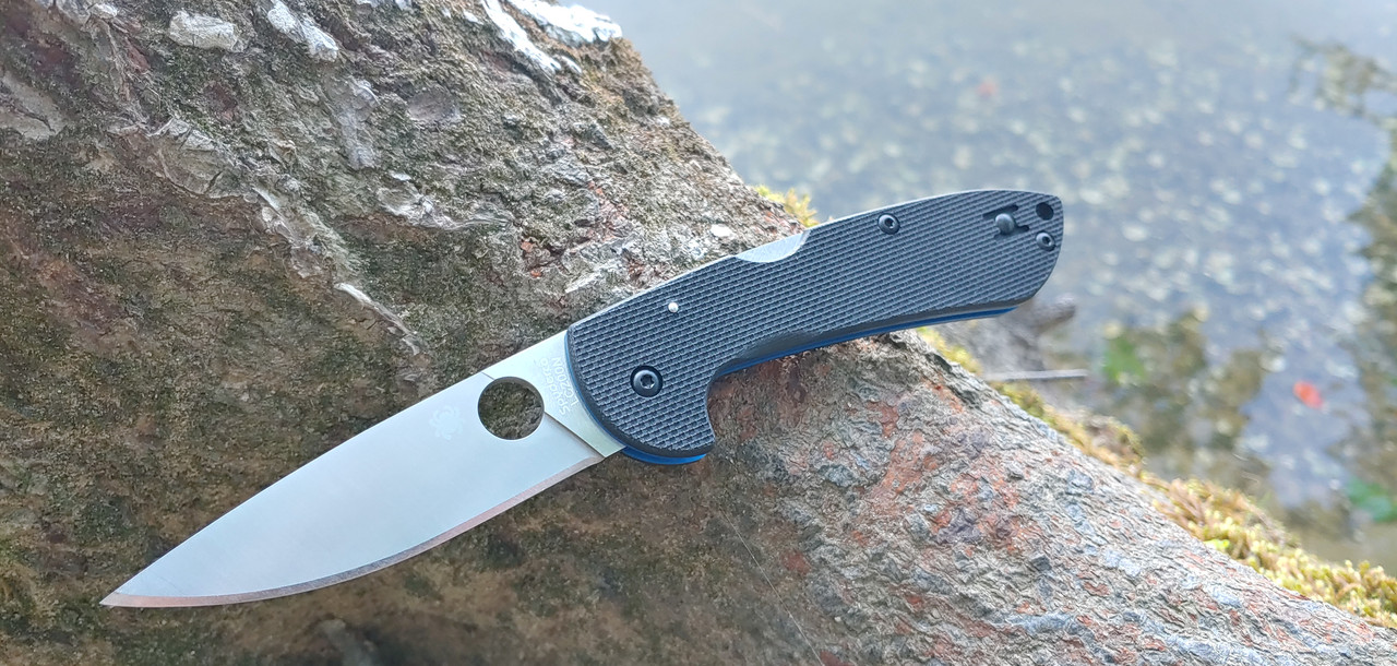

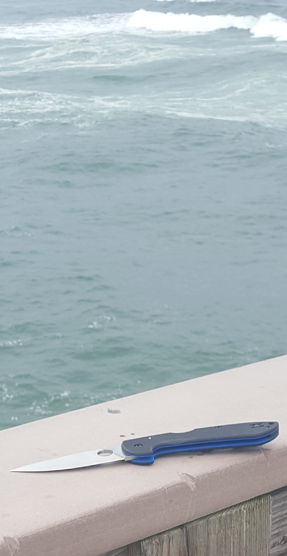

The Siren is a rust proof linerless lockback folder designed by forum regular Lance Clinton. It bears many similarities to the Waterway fixed blade, which you can see me use in this video.
While the knife is marketed as a salt folder, I find it to be an excellent general purpose design. The knife is very light and folds into a compact package. It's wonderfully balanced with a versatile sweeping belly blade shape.
My Endura 4 wharncliffe is 3.39 oz and the Siren is 3.46 oz, so you're looking at roughly the same weight as an Endura 4 despite the larger, more palm filling handle and longer cutting edge.
The overall quality is noticeably higher than my beloved Pacific Salts. Everything feels smoother and more refined, from the pivot action to how well all the parts fit together. It really feels like a one piece handle.

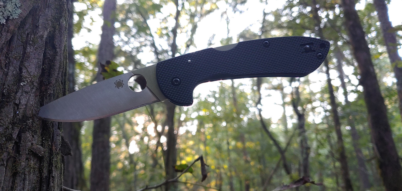

Three features of this blade I immediately appreciated were the efficient use of space, the lack of a thumb ramp, and the narrow tip.
The Siren does a good job of packing a lot of cutting edge into the blade for a lockback. It has about half the wasted space as my Pacific Salt 2:

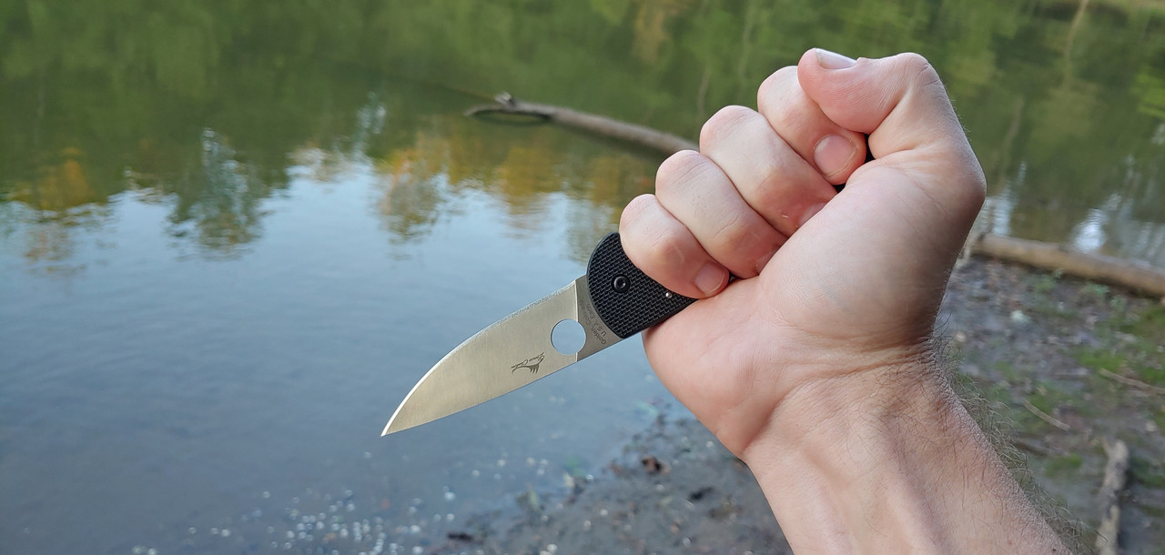

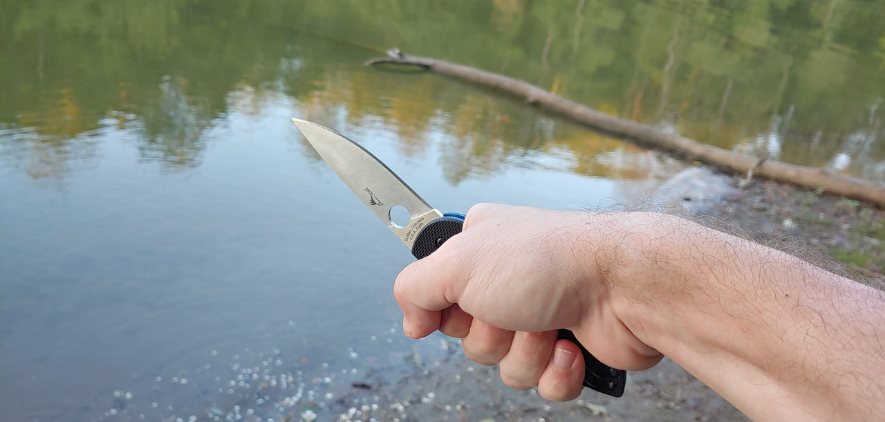

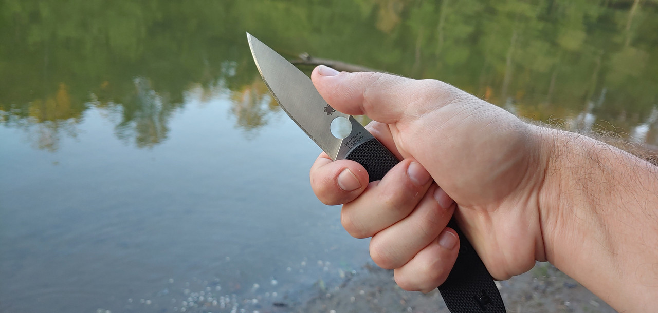

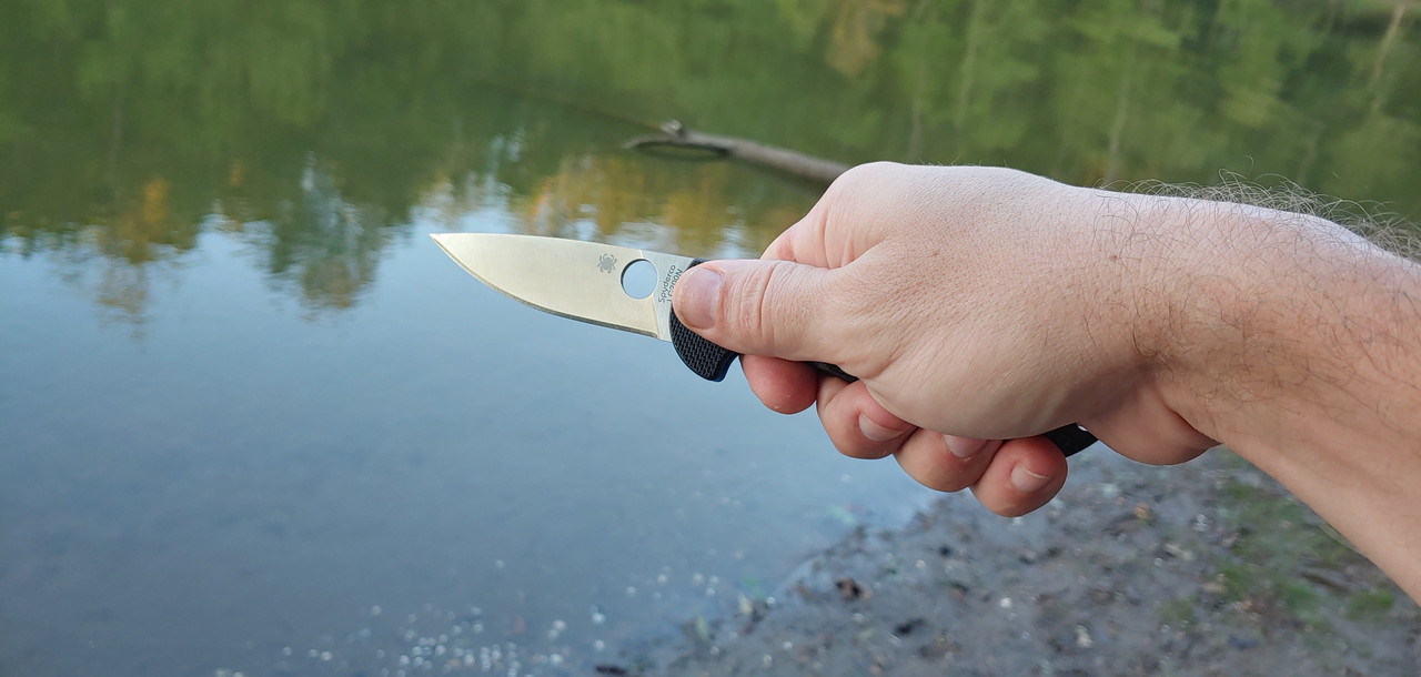

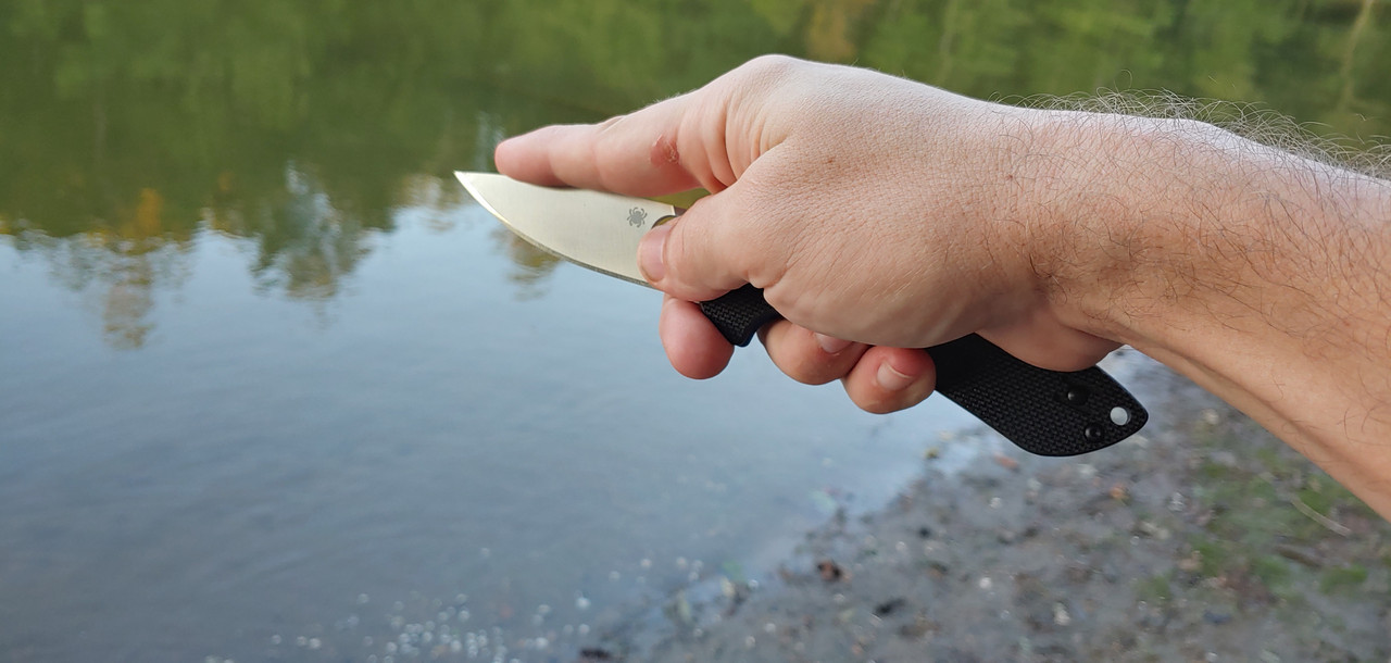

With no thumb ramp to restrict my grip I really enjoy the ergonomics of this knife. Choking up or holding the knife in the regular grip, my thumb always has a comfortable place to rest.

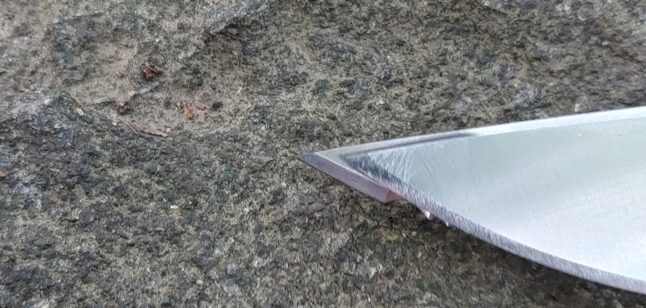

The spine of the Siren came with very crisp corners. So sharp I ran a ceramic rod over them for a couple passes to take the edge off. I like sharp spines because they're perfect for throwing sparks from a ferro rod.
The Siren does this job very well, as you can see here

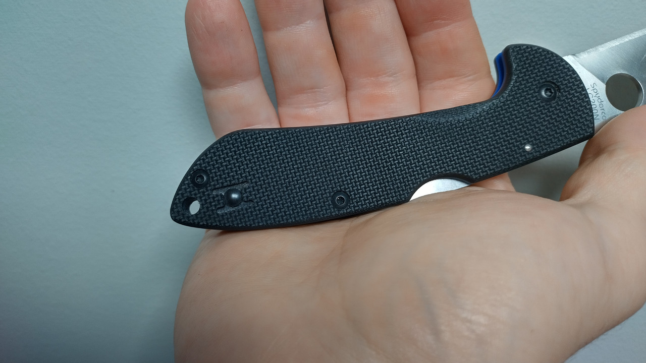

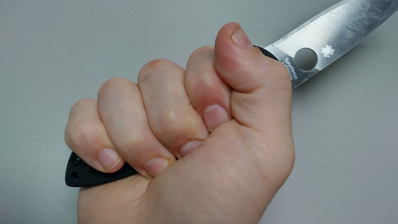

The Siren's handle is a nice general purpose shape. It fills my large hands well. I think it would fit my grip a little better if it were maybe 10% bigger overall, but the size used probably had wider market appeal. Here is how it looks in my XL-XXL hands in a variety of grips:
The texture on the scales is extremely grippy. They surprisingly don't feel abrasive to my hand. The Waterway is a bit more abrasive feeling. I really like the feel of the texture while using the knife. Extremely grippy but never uncomfortable or sharp feeling. The scales are fully chamfered along the edge and there's no hotspots anywhere.

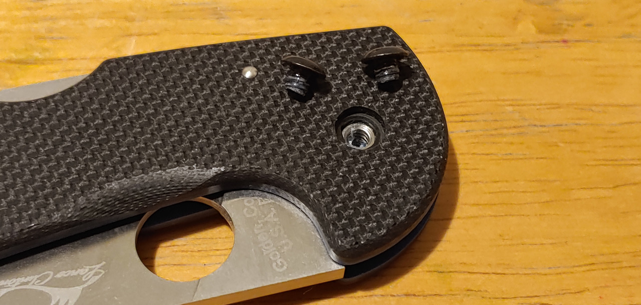

I attempted to break down the Siren so I could photograph the insides, but the only screws I could get to release with my torx driver were the pivot screws. Neither the clip screw or body screws would budge with hand strength alone. They may require heating up whenever I have to clean the knife.
Here you can see the thread locker residue on the pivot:
If you want to see the insides search youtube, there's videos up there.

1.) As you might know, I personally choke up comfortably on the Ricasso of Endura /Pac Salt (and sometimes even on the very edge) all the time, it is probably my most used grip.
Now I see you do so with the Siren too (while I think you rarely choke up on the Pac Salt Ricasso?) - so I assume this grip option is actually rather comfortable, safe and useful?
2.) When holding the knife with all fingers on the actual handle, your pinky obviously sits in the area where the back end of the handle starts to bend upwards again (and not in the space behind the front guard that seems to be dedicated for the fingers to go) - does this cause any issues, discomfort, less control? (Though I don´t think so, cause if you would have mentioned it)
