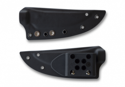

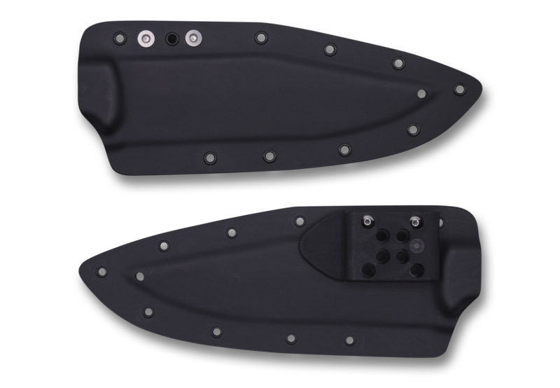

The Boltaron sheaths will be available very soon. The first batch is in-house and just needs to be added to the we site. Both are made by Sheath Pro and are very well done. The Ankerson has a great snap fit. The Bow River, due to its handle shape and lack of a retention point for the Boltaron, has a very clever wedging action between the spine and the handle. Very secure and very smooth.
I'm confident you'll like these.

With regard to the possibility of dulling the edge, both two-layer and foldover Boltaron sheaths align the seam of the two layers with the edge of the blade. As such, the edge nests in the "crease" between the two layers and is pretty much immune to contacting the plastic in a way that would dull it.
Injection-molded sheaths typically have interior cavities with right-angled corners. Viewed in cross section, these are long rectangular cavities with flat areas (the short legs of the rectangle) at the spine and edge. If you allow the edge to contact the flat as you draw and sheathe it, it can affect the sharpness of the edge. The best technique for drawing and sheathing with these sheaths it to "ride" the spine of the blade.
The squared corners and flats of the injection-molded sheaths basically replicate the "welt" or spacer used in leather sheaths. The welt is an extra layer that keeps the edge from cutting the threads used to sew the sheath together. Since welts are soft leather, they don't affect blade edges if contact is made. Injection-molded polymer is significantly harder.
I hope this helps.
Stay safe,
Mike
