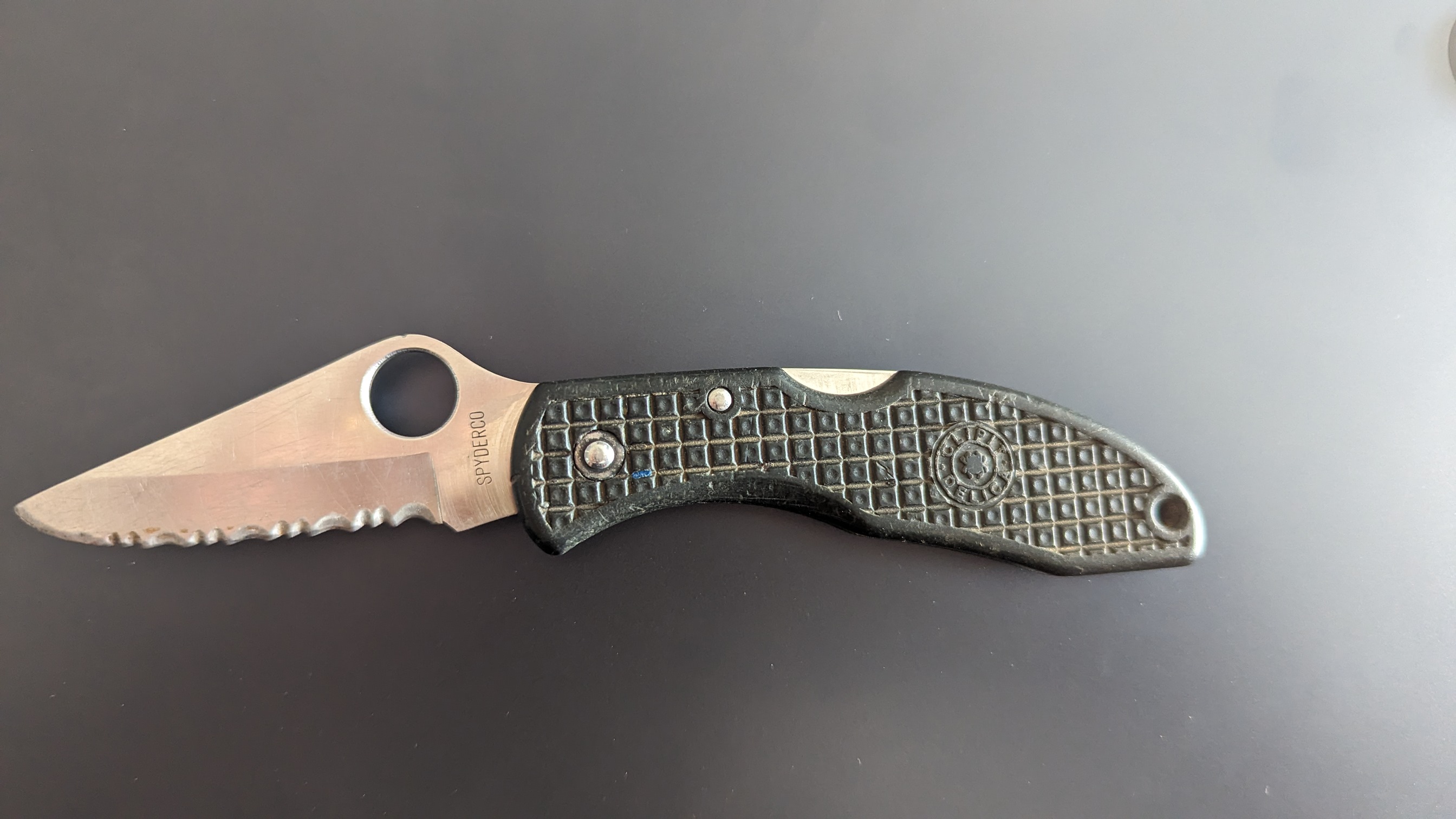

In the late 90s my father inherited this Delica from a military friend who passed. He used it (up) and then was gifted a new Calypso Jr by me a few years back. I held onto his old Delica in a box. Neither of us being knife collectors, we didn't value you it beyond a knife that had given a long, long service life and was familial in nature at that point. I've read through the forums here and elsewhere and this appears to be an original Delica, if I'm not mistaken. Original as in model 1, pre blade markings, Gin-1 I'm assuming from what I read above, but pre markings due to contractual rights on the steel. Unfortunately the blade has been broken and resharpened a bit, and my dad didn't care for the clip it, so it was cut off. Anyone else have one? Does anyone have an opinion on whether I could replace the blade or should, given it's somewhat rare nature? Sounds like Gin-1 might be available still? Am I wrong in saying the Gin-1 appears shinier or more chrome like than other tool steels?
Dave?Image

I don't see anything worth replacing the blade over. I gave one like that to my girlfriend for yardwork years ago. It was usually packed full of mud to the point it couldn't be closed, but she'd still be using it.
I don't know if actual GIN-1 is still available, but Carpenter has updated versions that work very well.
GIN-1 appears shinier and more chome-like than tool steels because it is not a tool steel, it is a stainless steel.
Edit to add: Welcome to the forum! There is a lot of knowledge floating around here.
