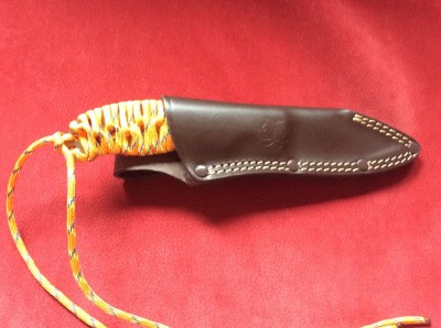

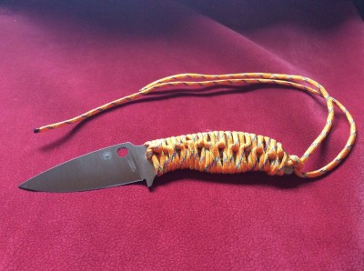

Well, apparently I have significantly less talent and patience than you. :rolleyes: And I think I made a few wrong turnes, which resulted in a much lower level of symmetry and beauty. Makes your result even more outstanding. But that's ok. I am ok with my result:
Once again a big Thank You, yablanowitz!
