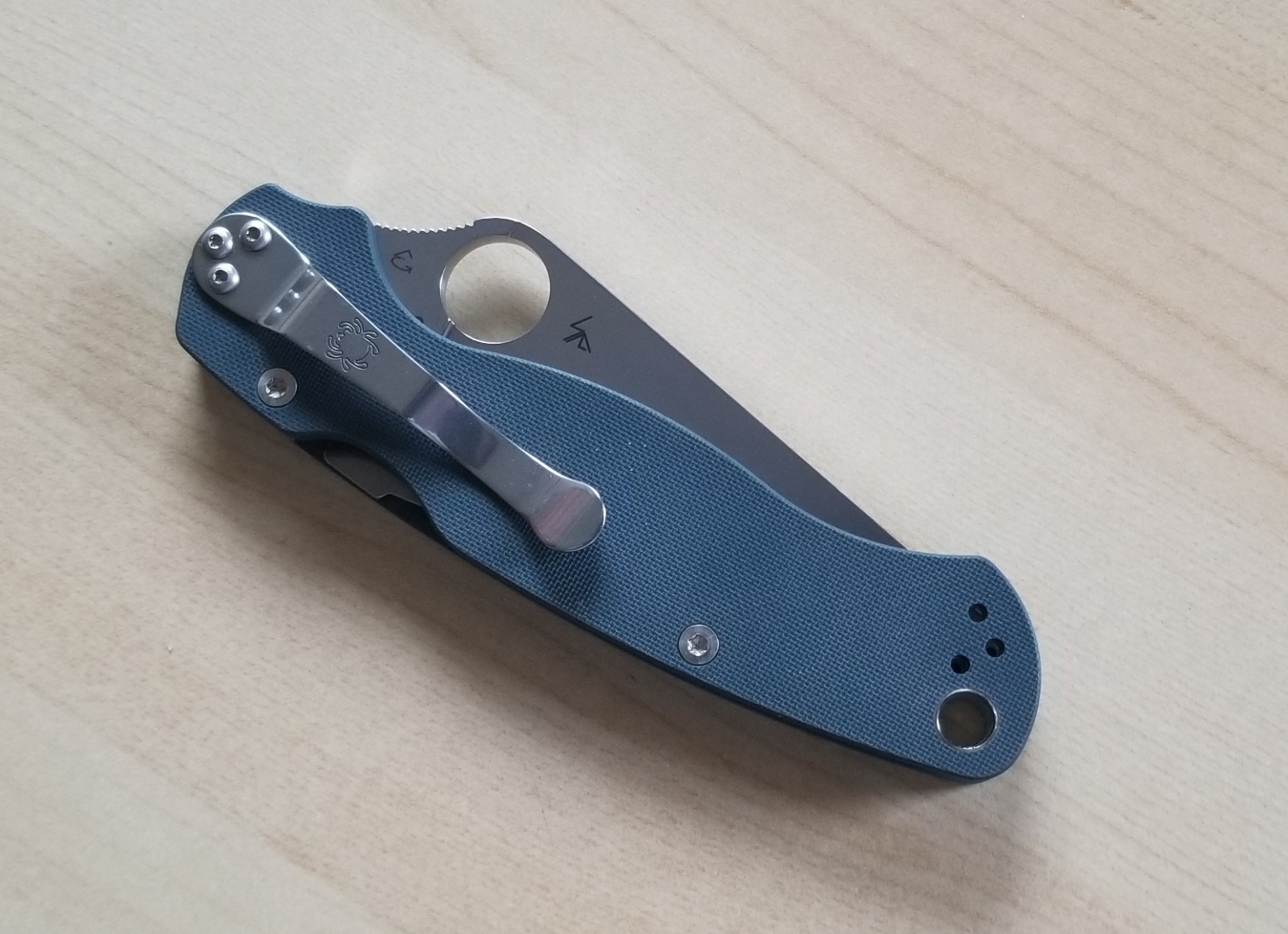

FRN UKPK. Previously modded with smooth natural g10 β€œjade” scales from Cuscadi. Dyed today in RIT DyeMore Peacock Green for 10 minutes. I may do another round and go slightly darker.

Spyderco Alcyone with a modded blade and black handle scales

Fresh Maxamet PM2 grey G10 after about a minute in teal RIT dye.
