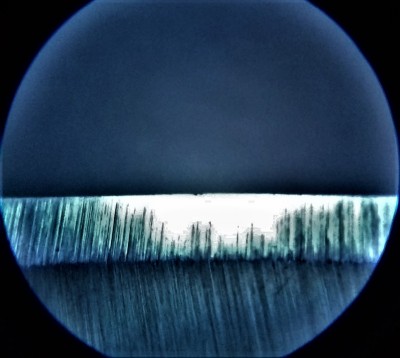

I did not think this cheap microscope, intended for kids, or my shaky hands would yield any result. This is the MagnaCut Mule under the scope.
I speed whittled 2 more yoghurt tubs of shavings being careful to follow through and slam the cutting board 50 or more times. Ok, its not cutting nails but it does represent a common careless cutting error.
The result is very micro chips out of the edge, barely visible in the center of the light. There are 2 chips or one defined tooth, it is so small that it would not exist for any normal knife user. But, it is there and it has been fun doing what I can with the stuff I have to see it and see what this steel can really take.
