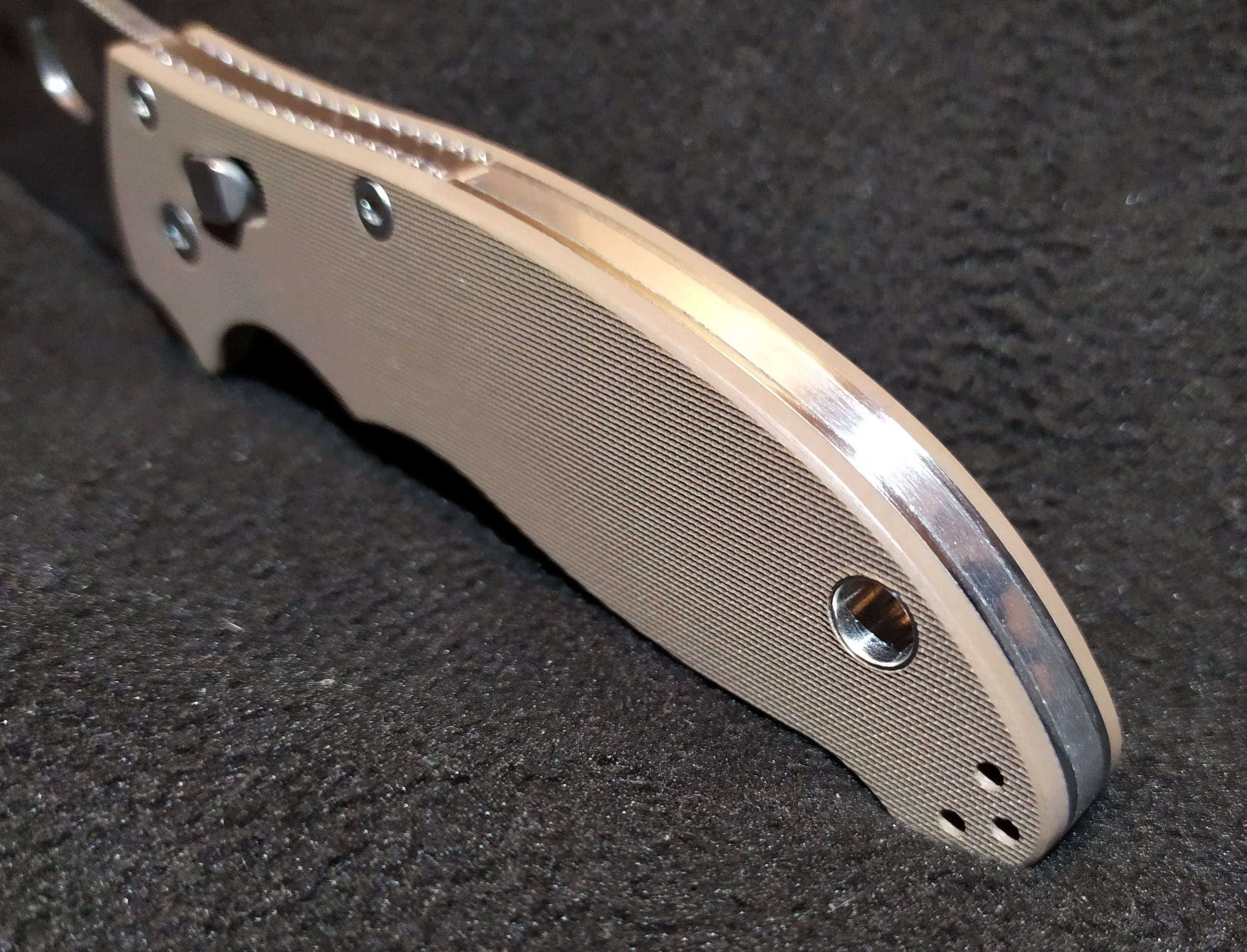

by Senfkarte
This thing was better than great, when it left the factory.
Now it's my personal dream Manix 2.
The changes I made: A titan ball cage, ceramic ball and a back spacer made out of aluminium.
The cage is just for the aesthetics.
Now all the hardware is silver/metallic. Locks cleaner, simpler, more fitting. I even have the feeling, this change alone is enough to let the brown appear more gray/brown, which I like.
The ceramic ball has no purpose.
I just had it laying around, got it for cheap some time ago. Have ordered some ball bearings and the shop had the right size for a few bucks, so I just put some in the cart. The stock steel one is just perfectly fine.
The back spacer is functional.
A back spacer protects the edge. And eliminates a hot spot, when really gripping hard or pushing down on the knife. Nothing that is needed every day, but still a nice to have. And it just looks better. At least in this case and in my opinion.
Yes, there is no clip on this knife at the moment. Can't really say why, but this knife is carried loose in the pocket. Maybe because I mainly carry it in and around the house. That's just how it is at the moment. It may change in the future.
Pretty sure, the screws are too long with the back spacer, so I would have to shorten them first. This would be a little bonus modification.

Awesome work! I really like the backspacer! I like open back construction on some knives, but more typically prefer the edge protection provided by the closed back, as well as the ergonomic improvement.

That's a sick backspacer!! Haven't seen one like that before. Very nice.

How is the backspacer attached/installed? I'm thinking of doing something similar, but I haven't thought too much about it yet.

If it were my knife, I'd try to drill and tap the backspacer, rather than shorten the screws. Barring that, I'd drill shallow relief holes for the screws so no screw shortening would be necessary.
The backspacer encloses the lanyard tube and rests against the anvil (that's what Spydercos calls this piece, at least) while its contour is fitted to the anvil.
I actually made some pictures while making it. Here you can see the spacer without one of the liners installed.
Bolster wrote:
Sun Jan 07, 2024 8:29 pm
Drilling holes, a little bigger than the outer diameter of the screws, yes that is also an option, I thought of.
Tapping the holes, no. In this case, it most likely would work, but in general you don't want "continuous" threads in two plates, that rest on another. Thats not the way screws are intended to work.
Without the backspacer the screws also just are in the liner and every part of the screw, that is longer doesn't hold anything in place. So shortening the screws ist just the easiest and fastest way for me. Of course these screws are then custom to this specific Manix 2. But that's something I could live with.
Just to add, my collection of imperial tools is pretty limited. I think the screws that come in Golden made Spydercos all are imperial? Taichung uses metric ones? For the other factories, I have no idea.

I'm glad I read this thread because it may just help solve my problem.
