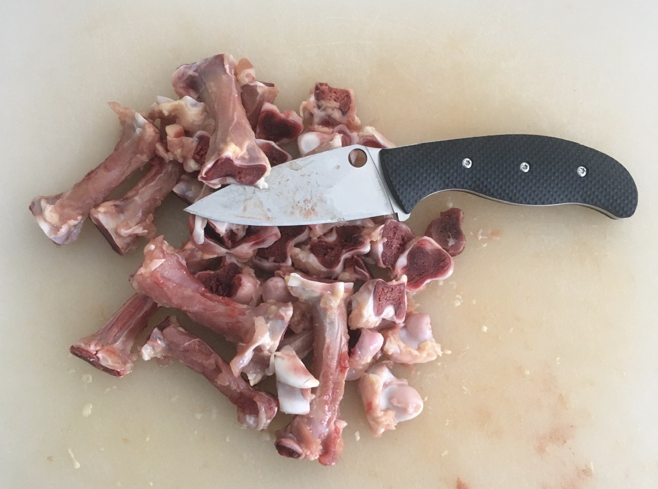

I lightly micro-beveled the factory-edged Magnacut Mule and prepped 10 bone-in chicken thighs for some of this week’s dinners, using this mule for the whole job. I made no effort to avoid contact with bone when removing the meat and even cut the ends of the bones off in preparation for making stock.
I used from the tip to about 2/3 back, and the edge is still razor sharp. The bone had no ill effect on the edge, even when I had to strike the spine to get the edge through the bone.
The 1/3 of the edge nearest the ricasso had more use on it from earlier in the day, and it only has a few reflective spots after whittling and torquing it out of some seasoned oak a bunch of times.
Most of the edge still scrape-shaved at least.
I think I might also chop the bones through their middles to further expose the marrow before making the stock in the future to see how Magnacut fares.
