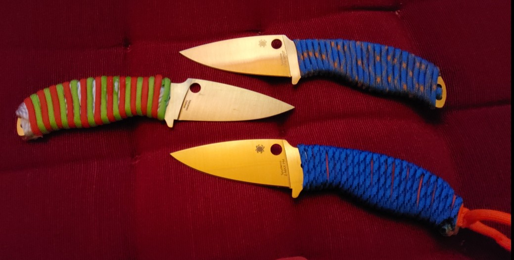

Posted: Mon Jun 21, 2021 2:15 pm
by archangel
I know, they really suck compared to your guys' beautiful works. But I still like them. May this inspire other untalented folks like me to give it a try rather than simply buy HT factory scales. ;)
