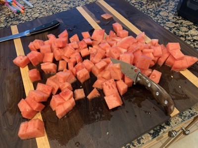

Thanks Xplorer!
I got lucky in that I am the knife guy and he is the wood worker. Together we have a lot of fun. We found some more scraps of walnut laying around and got to making a few swappable sets. We are both putting together a hiking/camping setup and it’s turning out better than the first go. We also worked out the dimensions so I can use the kydex sheath I bought when I first got Halpern contoured scales. The Mule had watermelon duty tonight. We did the board in the pictures and these scales around the same time.

Great pics! It's cool to see a hand-made Mule handle at work. That's a great looking cutting board too :cool: .

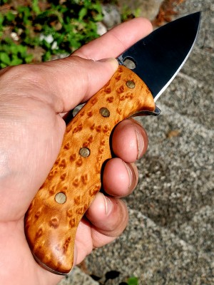

#1316
Post by joeldworkin307 »
Xplorer
Posts: 1344
Joined: Sat Apr 18, 2015 11:41 pm
Re: Show your Mule
#1317
Post by Xplorer »
^Beautiful! The wood is gorgeous, and the liners and hardware look great too. What a great Mule you have there now!! Nice work.

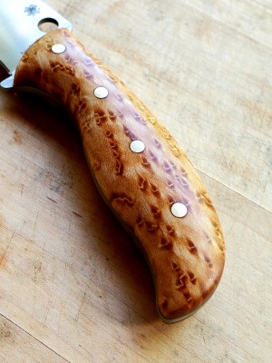

^ Agree, stunning. What is that, some kind of tiger stripe burl...walnut? Or what? And are those copper corbys? Nice!!

That chocolate and vanilla is sweet! I really like the clean reveal around the edges.

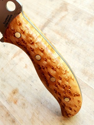

I finally had a chance to use my new S45VN with the Birdseye Maple scales. The boiled linseed oil finish finally cued enough that I could use it.
Not much of a test but it sure made short work of the fathers day barbecue duties.
Ah...I'd asked what finish in another thread, I should have looked here first. Very nice, very very nice. Now I'm on the hunt for some birdseye maple. I can't tell if the orange cast is the wood, stain, or the setting sun, but I really like the look.
Did you try the trick of sanding the scales with >500 grit while still wet with BLO? I did one scale that way, and another with no wet sanding, and the wet-sanded scale is noticeably smoother.
