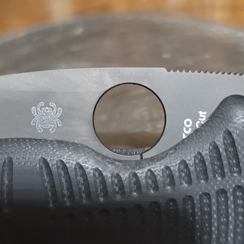

I just tore my Shaman down last night and I sculpted or fluted the scales on the side I thumb my knife open. I have bigger paws and my fat thumb needs all the help it can get...
If you look close at the Shaman there is a small amount of the thumbhole that is below the edge of the scales...
I took and used a small fine halfround metal file and worked mine over. I didn't do anything on the clip side of the scales. Here is a pic of mine. You can see the scales through the thumbhole on the clip side. That is a reflection of how much I chewed off lol.
