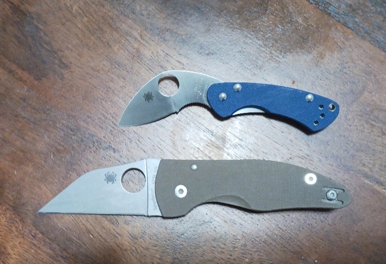

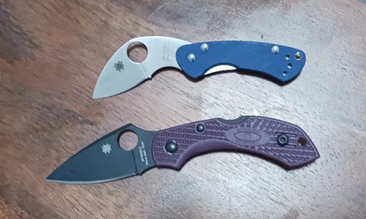

The hawkbill that the Balance is most similar to in size is the Ladybug 3 Salt Hawkbill (the Balance is somewhere between the Ladybug and Manbug in opened length, but has more handle to hold onto than either because of its finger choil). Unfortunately, I only have a regular Ladybug 3 Salt so I can't really make a direct comparison between the Ladybug hawkbill and the Balance.endura3 wrote: ↑Tue Nov 04, 2025 8:10 pmThanks for reviewing this! The design looks like a really great utility cutter with that negative blade angle. Glad you got one and have been able to put it to use. Compared to a similarly small hawkbill, do you think the blade more easily slips out of utility draw cuts like separating cardboard, or is it a similar feel? I'm trying to envision what cutting with this is like but I don't really have anything comparable.
I do have the serrated Dragonfly 2 Salt Hawkbill, though, and can compare the two FWIW (just keep in mind that the DF2 is much larger than the Balance). The DF2 Salt Hawkbill has three things that can conceivably keep it "in the cut" better than the Balance: (1) a tip that fully follows the inner curvature of the blade, (2) serrations, and (3) a much larger handle. The Balance has significantly thinner blade stock and a full flat grind (the DF2 Salt, as well as the Ladybug 3 Salt Hawkbill, are sabre-ground), however, which makes it a much better slicer. Those qualities mean I don't have to bear down on the Balance as much when making utility draw cuts, lessening the likelihood of the blade tip slipping out from the material. So all things taken together, the Balance has a similar feel to a small hawkbill in practical use, and I imagine one will have an easier time using the Balance than the Ladybug 3 Salt Hawbill to cut most materials (outside of rope or netting) because of the former's thinner blade.
The Balance's small size and unique shape also make it so that it's very easy to index and orient it in hand and how I end up using it a lot of the time is I have it in the crook of my index finger. Held that way, I have a lot of control over the knife and can keep the blade tip where I want it to be at all times.

This is super helpful - thanks so much for your detailed reply! It does sound like an extremely capable piece for the size.zuludelta wrote: ↑Wed Nov 05, 2025 3:47 amThe hawkbill that the Balance is most similar to in size is the Ladybug 3 Salt Hawkbill (the Balance is somewhere between the Ladybug and Manbug in opened length, but has more handle to hold onto than either because of its finger choil). Unfortunately, I only have a regular Ladybug 3 Salt so I can't really make a direct comparison between the Ladybug hawkbill and the Balance.endura3 wrote: ↑Tue Nov 04, 2025 8:10 pmThanks for reviewing this! The design looks like a really great utility cutter with that negative blade angle. Glad you got one and have been able to put it to use. Compared to a similarly small hawkbill, do you think the blade more easily slips out of utility draw cuts like separating cardboard, or is it a similar feel? I'm trying to envision what cutting with this is like but I don't really have anything comparable.
