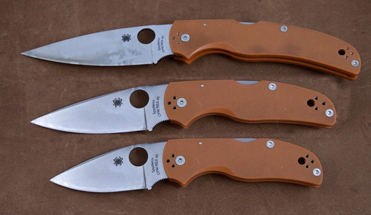

If I keep asking, maybe it will happen. The in-between Native.
Re: Sal asks you to design a Spyderco.
In between what two?
Greg
MNOSD member #0054
* EDC - Shaman SPY27, Calypso Jr. Super Blue (both from OKCA SHOW in Oregon)
* EDC fixed blade - Mule MagnaMax
MNOSD member #0054
Oh, it's a 3.5 inch Native positioned between the 3" Native 5 and a 4" Native Chief.

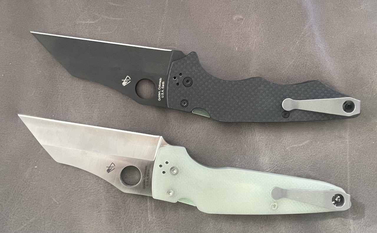

My husband, @vandymangm, won’t post this, so I took a picture and am posting it for him! I am impressed. He has a lot of details written about the knife in the picture. Hope you like it like I do!
I’d be happy to see a factory version of my modded Yojumbo. It adds so much to my personal ergonomics and you can hold it more ways than the original. You can get your thumb on top of the blade to put some force on it or have the cutting closer to your hand so less fatigue.
